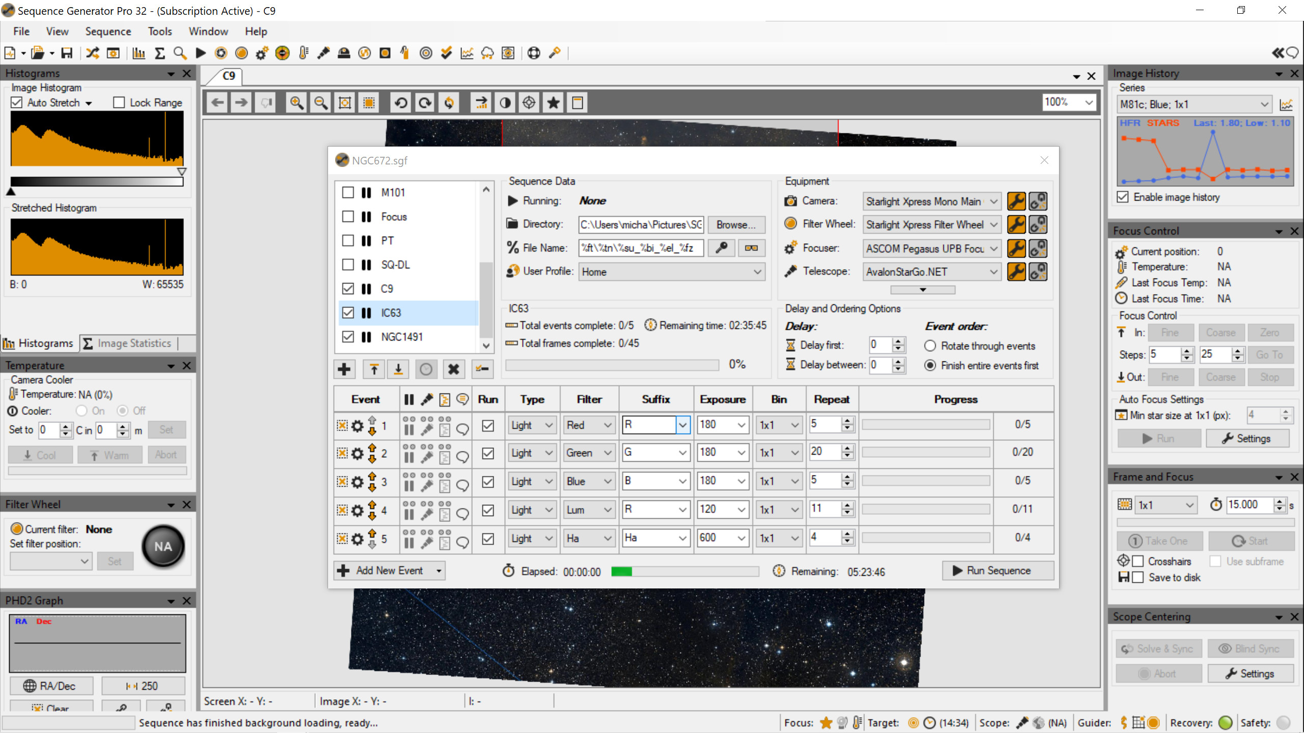

When I was first starting with AF I would use the Coarse In/Out buttons on the Focus Control tab, see RHS in below screen-shot, to move the focuser. Take an image after each move (Take One on Frame and Focus Tab) and you should be able quite quickly if focusing is improving or not - change direction as appropriate. Use the Fine control when you get close to your HFR 2. NB. My step size values may not be appropriate for your rig. Adjust as needed until you start to see a decent change in HFR.
If you have not already done so I would also check what distance your focuser needs to move to get from best focus HFR to approx 3 x this value. If you are using 7 steps for focus your step size should be about 1/3 this distance. If AF only detects 1 or 2 stars then I suggest you reduce the stepsize so you have at least 4-5 star detections. You might also increase your exposure time to see if that gets better data for the AF routine. Once you have things going nicely you can decrease exposure to speed things up.
You donā€™t say if you are using filters but you will need longer exposures for RGB filters compared to Lum. I also found I needed to decrease the step-size to get focusing for RGB filters to work well as there will be fewer star detections with these filters compared to L.

Thanks, MIke. Quick question - Does SGP include a pointing model, like T-Point?
Also, I"m using an OSC, so filters are not currently an issue (planning to use LP or narrowband when everything else settles into place.)
And good tip about Take one - I use it on the continuous setting when I am manually adjusting focus. My step size is usually 50, and the exposure depends on what I am pointing at.
So many variables!
Thanks again.
