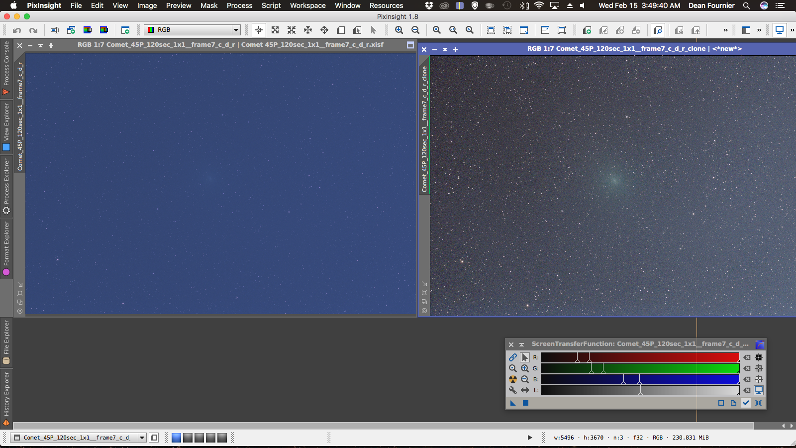

Okay I think I have sort of figured it out. What seems to be happening is that somehow the green of the comet is confusing something in the colour balance while debayering, resulting in the bright blue sky and pink stars. This is my first time processing a comet, and the first time I ever had a problem with colour balance and processing with Pixinsight and the 6D. I thought there might be a connection.
I actually AM able to stretch the image. When after debayering I saw the blue image on the left in the screenshot, I assumed it was already stretched somehow. In fact it is not…it is still linear. Stretching it using the STF gives the image on the right. Much better colour, though with lots of gradient caused by the almost full moon. So I will go ahead and finish processing it and then adjust the colour balance.
Dean
hm, the PI debayer process does not do any color balancing. if you use DCRAW to debayer the images then the WB in the camera metadata might be respected depending on settings. but clearly given the _c_d_r naming of your files, they came out of BPP and so DCRAW’s debayer was not used.
anyway, after DBE the background should be more neutral.
Hi pfile,
Yes I have Pixinsight set to not colour balance…so I am kind of grasping at straws as to what is making the linear images so out of balance. It’s almost like the green had been removed, leaving blue and pink as the dominant colours to the linear image.
