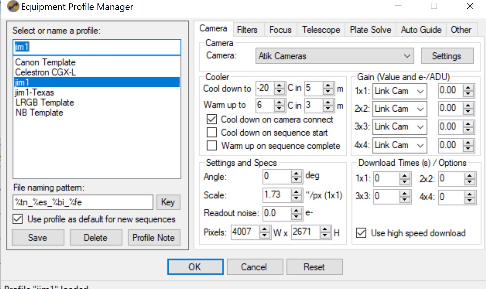

This is my equipment frofile:

I am not clear on how the SGP camera settings “angle” figures into any of this.

There are a couple of ways to do this. If you always use a Profile (vs the current sequence) to create a mosaic then you’ll need to update the profile with your current angle:
  • Solve and Sync your mount.
  • This will populate the Angle as well as other properties
  • Save this information to your profile (File>>Save Sequence as Profile)
Now when you create the mosaic:
  • Open the Framing and Mosaic Wizard
  • From the “Other Menu” select your profile that you updated with your angle
  • You should see the rotation angle is pre-populated (DO NOT CHANGE THIS!)
  • Draw your rectangle.
Same time of night and same side of meridian doesn’t really matter all that much. Your sky angle will always be “roughly” the same if you don’t move your camera. There are some notable areas where this is not true like near the pole.
As you cannot change rotation you will not be able to make any framing adjustments so you’ll likely be left with “un-ideal” framing for most mosaics as an example:
