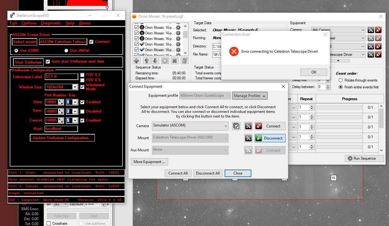

Ok, here’s the latest. For whatever reason I CAN connect PHD2 and StellariumScope to the Celestron Telescope Driver at the same time without any issue. But when I try connecting SGP to the Celestron Telescope Driver I get the “Error connecting to Celestron Telescope Driver”. Additionally, if I connect to the Celestron Telescope Driver through SGP first then try to connect either PHD2 or StellariumScope. I get the “Access Denied” message. It’s like SGP wants total control of the telescope driver. I uninstalled and reinstalled both SGP and ASCOM 6.2 but no change. I wanted to go back to ASCOM 6.1 and 2.4.3.23 to check to see if the problem goes way but I don’t have a copy of 6.1 on my system and I could not find it on net. Anyway the image below shows both StellariumScope and PHD2 connected and working together but when I try to connect SGP I get the connection Error.

It’s got to be something in my system but I just can’t figure it out. This first started when I Installed ASCOM 6.2 & SGP 2.4.3.24 a few days ago. before that I never had any issues connecting to the Celestron Driver. I though it would go away when I installed SGP 2.5.0.0 but I get the same access denied or connection error.
I checked and both StellariumScope and PHD2 are running as non-administrator. When I check SGP I noticed the run as Administrator is grayed out, So I assume it is running in non-administrator as well?
