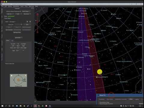

For info - these issues pop up regularly on this forum and so I did a video to share the settings I use to make Paramount and SGP to work together.
Chris, thanks for posting this. This certainly will save some people a few hours of frustration.
Kevin
