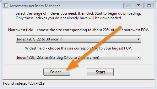

Assuming you have already download the index files for ASPS, you would go ahead and install ansvr and follow the installation instructions. When you get to the part about downloading the index files, click the Folder button
and browse to your ASPS index files folder location and click OK. ANSVR will then use the ASPS index files and you won’t need to download anything else.
