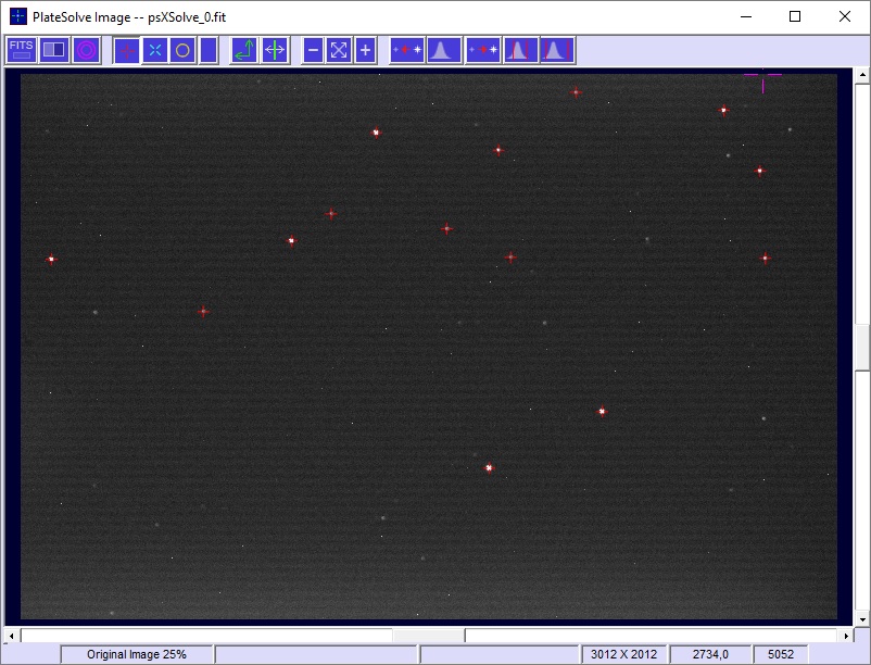

As I get closer and closer to full automation, I seem to be taking two steps forward and one step back. After some previous feedback, I’d set up to use PlateSolve2 and was generally successful. I ran into some problems when I started a new target due to not having the settings in the profile, but otherwise was able to recover and get things working. I also recently attempted turning up the gain on my camera to improve my DSO imaging and while that added some headaches due to hot pixels I was able to tweak the settings and resolve that. So long story short, last week I targeted and plate solved on BlackEye just fine. However, a few days later (over the weekend) no go, regardless of how often I tried. Looking at the image in PlateSolve2, it was highlighting the correct stars, and if I captured a screen shot and uploaded to Astrometry.net , it solved fine with the Blackeye just outside the FOV on the lower left. I went back and enabled astrometry.net as the failover solution and it still didn’t work. Any thoughts/suggestions?

Well, the temporary plate solve FITS isn’t kept, so I don’t have anything to show, but the pertinent portion of the log is below (and doesn’t tell much).

I’ll have to test again next time I get some good weather.
Beo
Don’t know if it is relevant but I usually bin my plate solve frames for speed but noted the other night that sometimes binned fails to solve when 1x1 works fine.
So, some additional feedback from my subsequent attempts to plate solve. First off, it would be nice if there was an option to seek, focus, THEN plate solve, rather than seek, plate solve, then focus. That would likely help. At any rate, starting from park, the attempt to center failed to plate solve, although it identified stars ok.
Uploading a screen shot of the image to astrometry.net , it solved fine, so I’m not sure why the fallover didn’t work.
http://nova.astrometry.net/user_images/2131838#extraction
After focusing and going back to solve, it did actually solve and center correctly this time, but when the dialog closed SGP pops up another dialog saying it failed to solve with a timer before running the end of sequence steps.
Not sure what’s going on there, but this is getting annoying.
