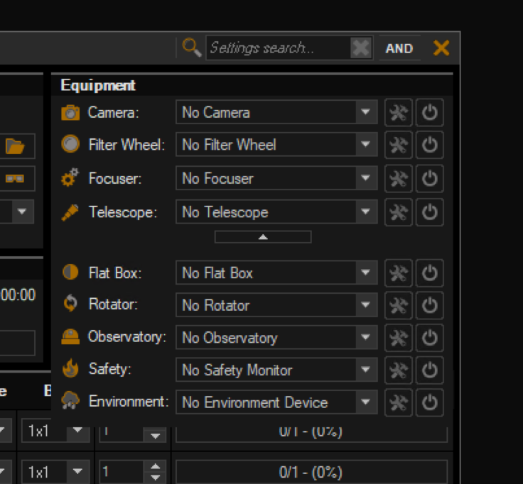

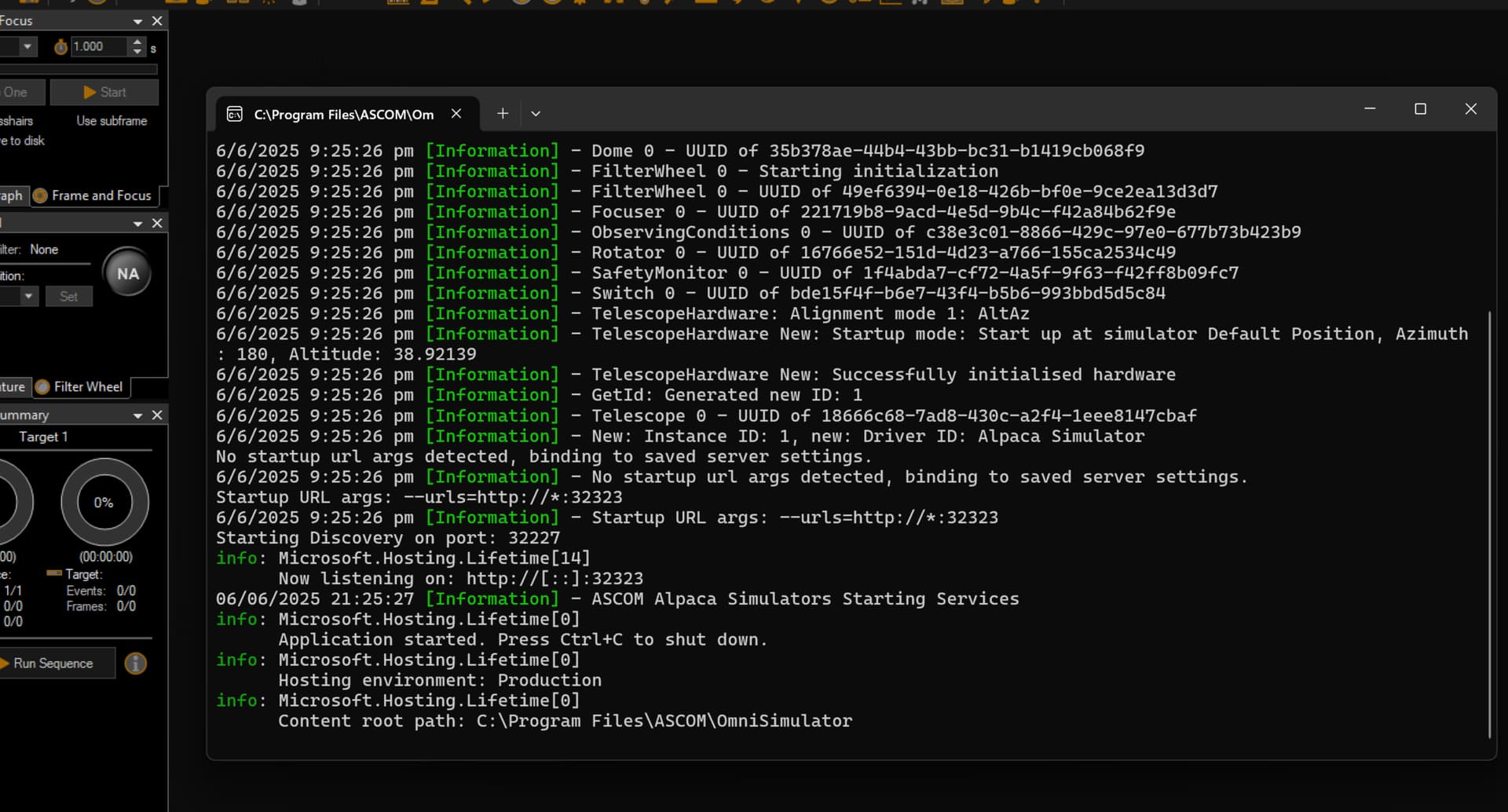

No device is selected in SGP, but the DOS window of OmniSimulator still open when SGP starts.
I see the DOS window opens, when SGP is saying establishing orbit.

The following 3 windows open but minimized-
1- PegasusAstro ASCOM Drivers Hub â I have this switch
2- ASCOM.ASCOMOmniSim.Camera Driver
3- A window for C:\Program Files\ASCOM\OmniSimulator\ascom.alpaca.simulators.exe

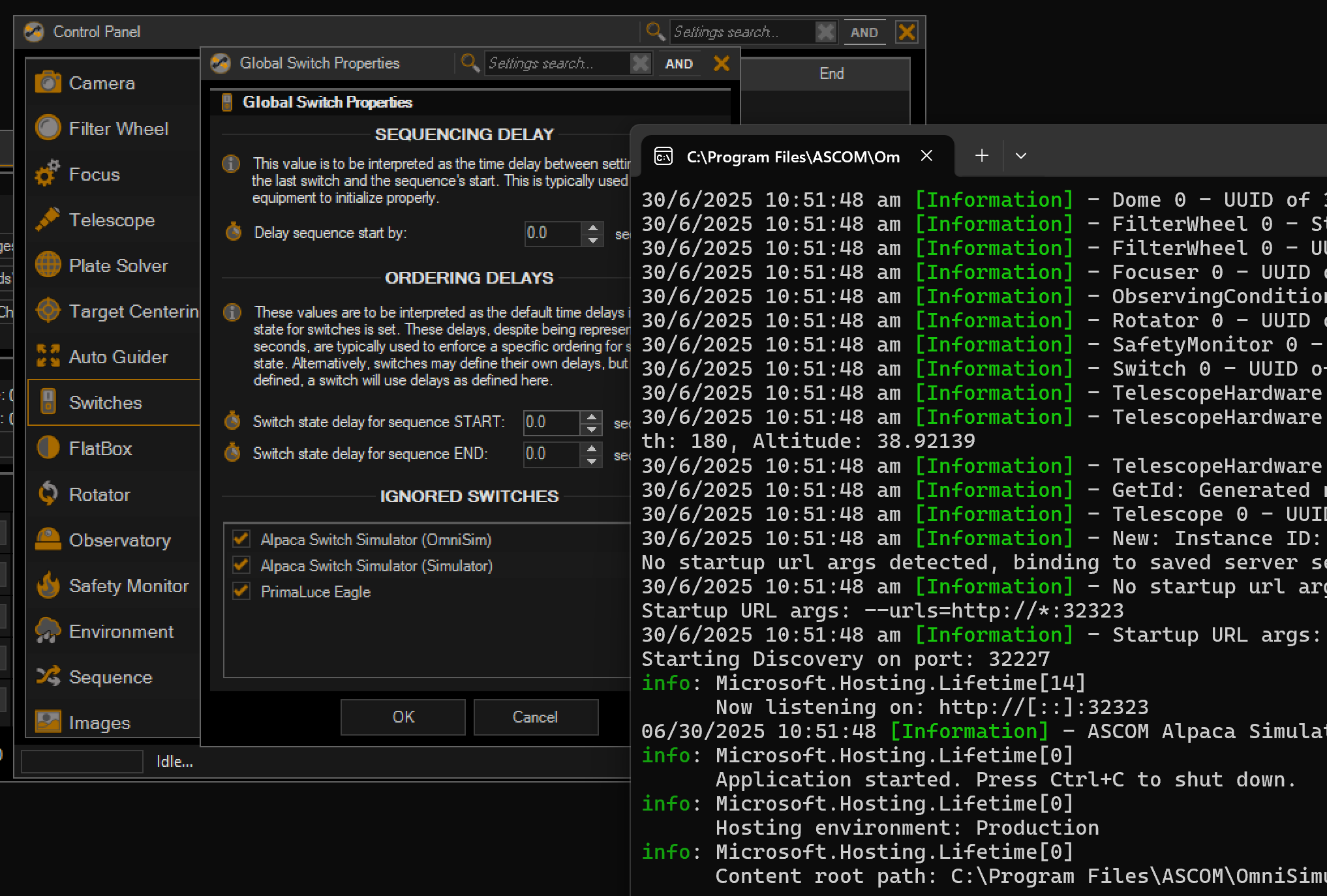

Setting the ignore switches didnât resolve the pop-up windows.

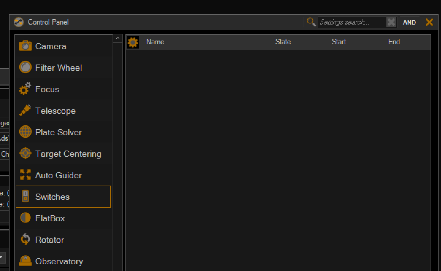

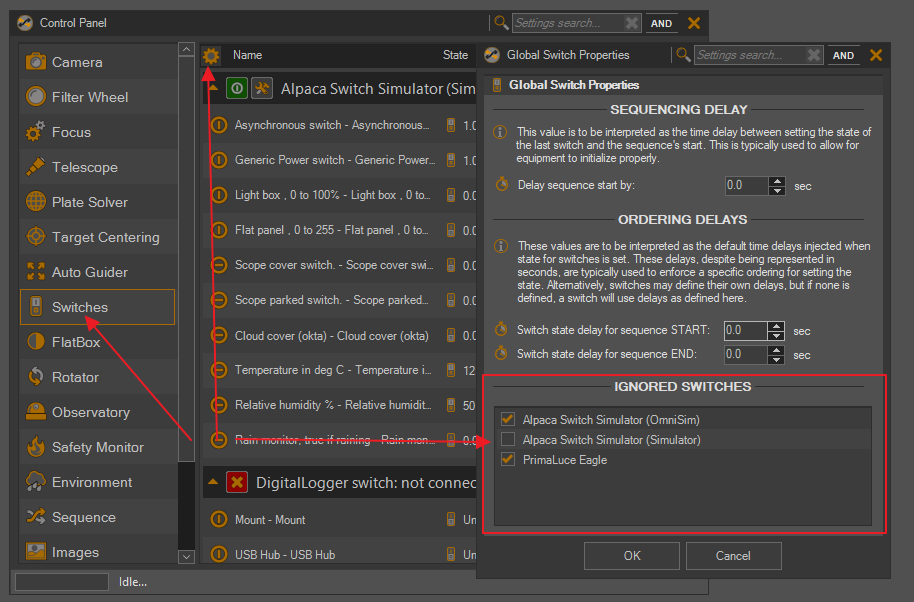

Control panel > Switches > right click on any Omni switch entry > select the global settings > select switches to ignore.
If nothing is selected in SGP, yet the Omni SImulator starts when you start SGP, then I donât know why. Something is connecting to the devices.

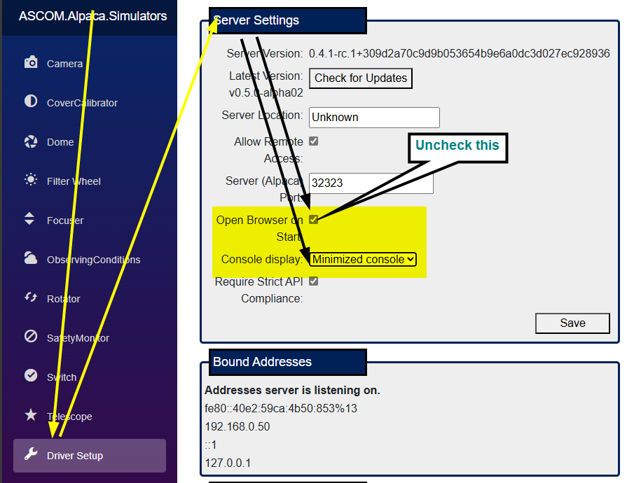

However here are the switches in the Omni SImulatorâs setup window (web page) that control the DOS windowâs behavior and the web browser popup when starting. To get the web browser setup later open http://localhost:32323/
Hi Bob,
I checked and found the Open Browser on Start was unchecked. I set the console display to âNo Consoleâ and that stopped DOS window from starting. I do get the small ASCOM.ASCOMOmniSim.Camera Driver window but it is minimized and non-intrusive.
I can live with that.
Mine is also having Open Browser on start unchecked.
I followed Mike and set Console display to No Console, the DOS Windows does not come again when SGP starts.
OK the tiny window comes from the âconverterâ driver used to provide access from classic ASCOM to Alpaca which the Omni Simulator speaks. This is handled by the Chooser one time. Since SGP does not (yet) know how to speak Alpaca this little window is going to be there. Like you say itâs no bother.
But even though the console window is hidden something is still starting the simulators. YOu probably want to learn what that is. I canât solve that problem from here ![]()

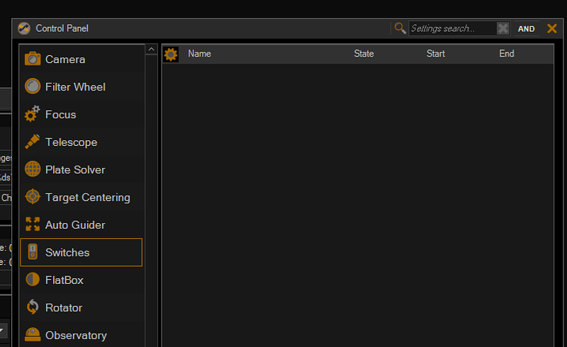

I followed the instruction to ignore the switches, with no item shown here:
Ignored switches:
but the ASCOM OmniSimulator windows still opens during the launch of SGP.
Ill need to think about this one. The issue is that SGPro is performing a check before any sequence is loaded to inventory all the switches present on the system. As part of this check, it needs to initialize the switch to see if it supports the more modern implementation. If it does, it is allowed to be used, BUT this check also spins up the Alpaca simulator.
Maybe we might need to introduce some kind of system wide ignore preferencesâŚ
