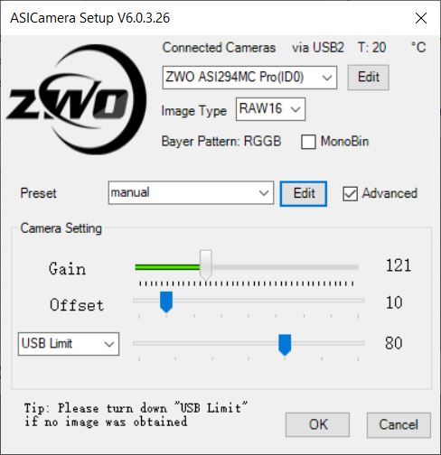

Ken, This is the problem with the Ascom driver:
You can set the gain for a specific event, but not the Offset value.
Normally doing LRGB you might use unity gain/offset, but moving to narrowband like Ha and OIII you can not change the Offset, only the gain. This is simply said not acceptable. It can be changed using the native driver though.
If you plan to leave the native driver, this is something you need to fix somehow.

I find this very strange because in the driver setup screen the gain/offset is fully configurable. You can select any combination of gain and offset you prefer. And that is how it should be for CMOS cameras.
But it cannot be done in the pre event settings. Why is that?
Because ASCOM does not expose the Offset for the camera. When using the ASCOM driver we have to abide by the ASCOM specification. And we can’t set something if it’s not exposed. Here’s the standard:
https://www.ascom-standards.org/Help/Developer/html/T_ASCOM_DeviceInterface_ICameraV2.htm
You’ll notice there is no Offset
property. But Gain
does exist.
The ASCOM Camera Setup dialog allows you to set other things if you choose. But SGP can’t access them.
