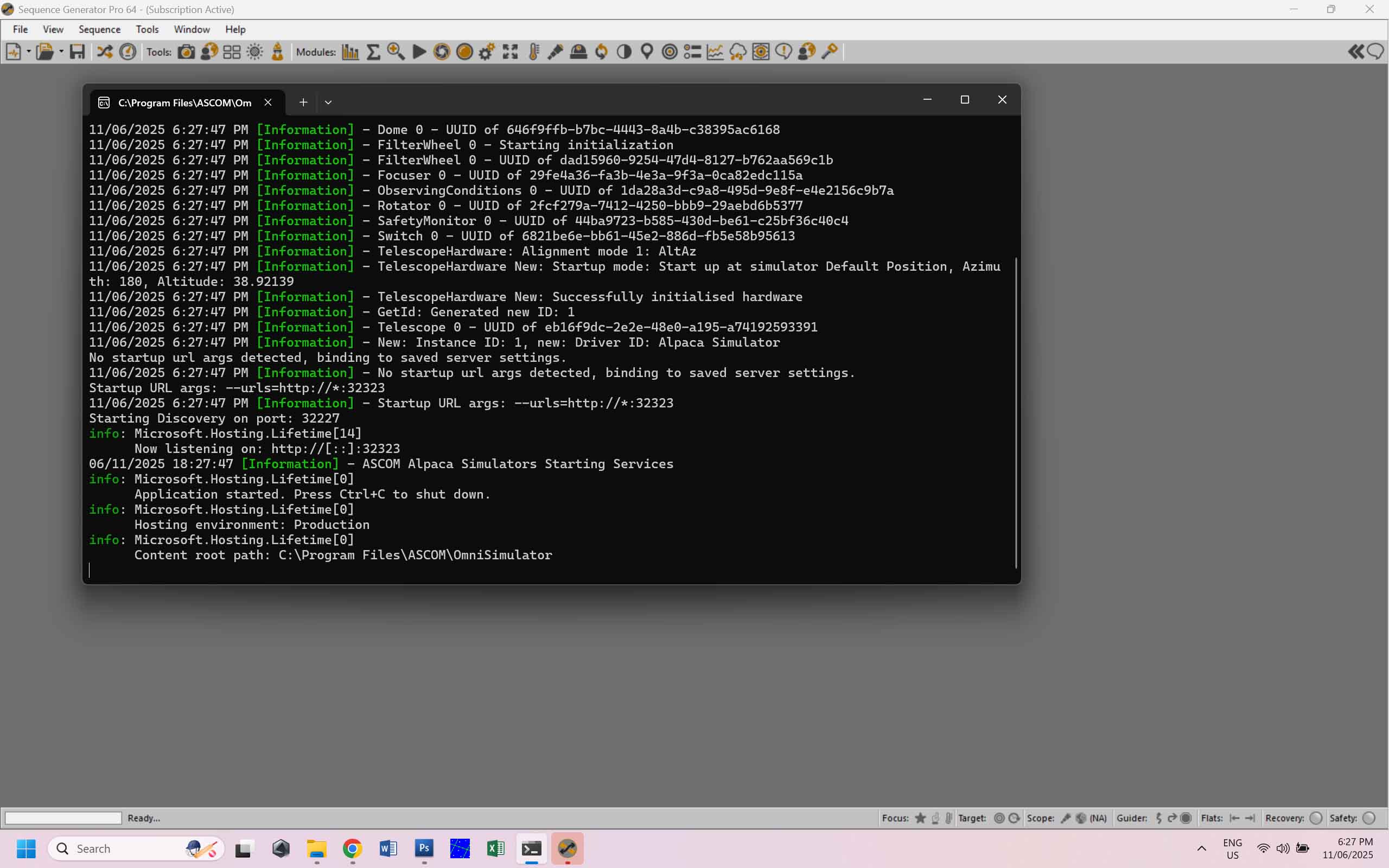

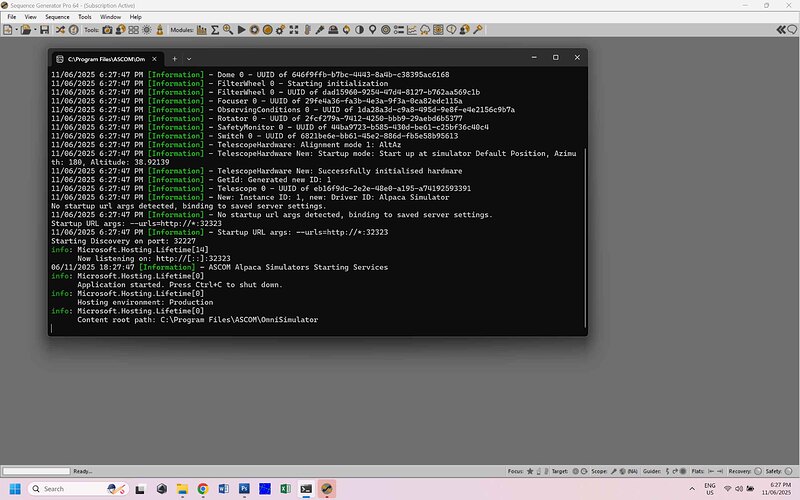

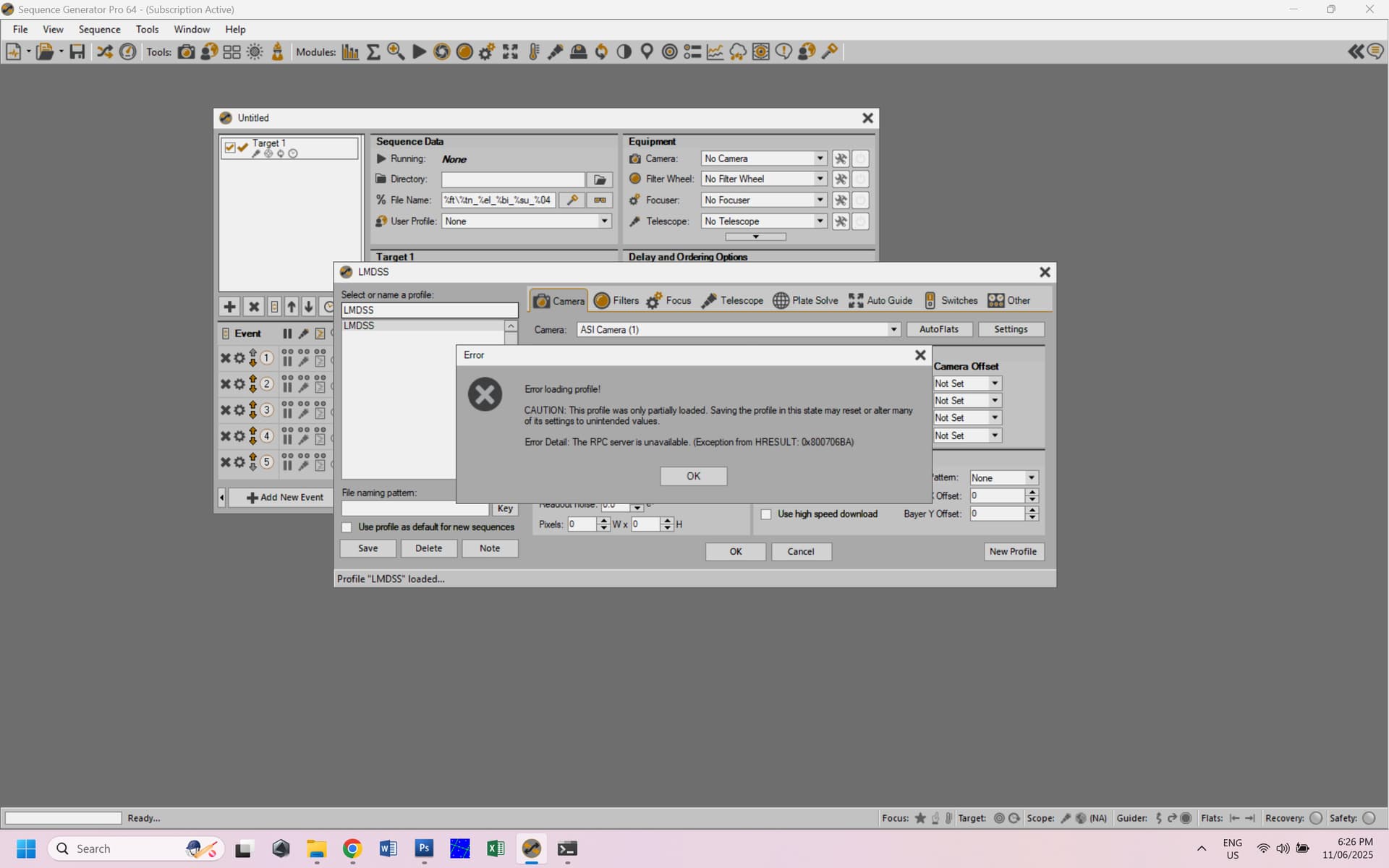

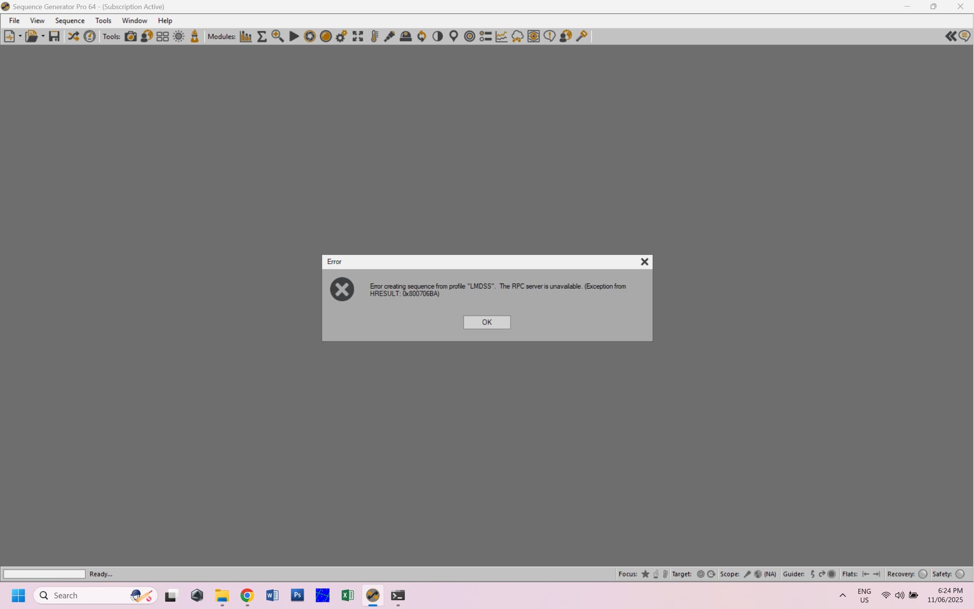

One of the immediate things I have run into is that the ASCOM OMNI Simulator is activated when I open SGP and when I open the Equipment Profile Manager. I then get a series of errors and I cannot save changes that I have made to my equipment with the error saying “The RPC Server is unavailable”.

So unfortunately I am back to square one. SGP Pro 4 worked for a little while and then again started getting the same messages. Seems to all be the issue with the ALPACA Simulator Devices I think and access to the local host 32323 hich I cannot access. I have tried to create a new equiment profile and still no joy.

So to fix this I un-installed ASCOM 7 and installed ASCOM 6.6 which does not have the ALPACA Simulators etc etc.
There is obviously a way to install ASCOM 7 without these (??) but must not have been able to do it.
SGP 4 now loads up without issues, pop ups and is able to access everything it needs.
Testing it tonight for a focus and imaging run so lt’s see!!
I would try to rename the folder C > Program Files > ASCOM>OmniSimulator
This should disable Alpaca.

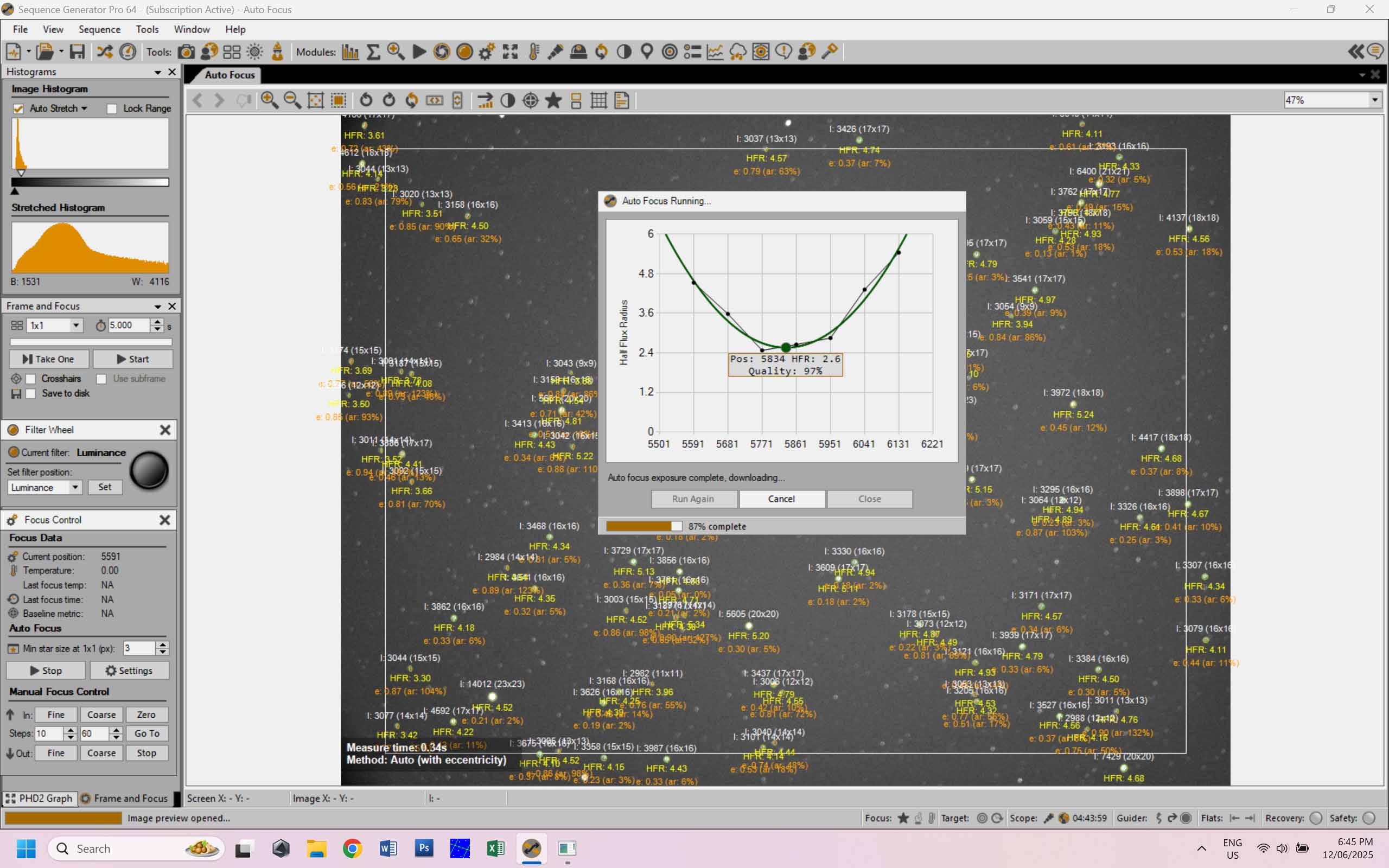

So first focus run testing tonight. Did get a focuser moving to new position hanging message and a dowloading imaging hanging error on another run stuck at 87% (screen shot attached)
I then turned off backlash compensation for my focuser and also disabled fast downloads.
After more than nearly 10-15 focus runs no issues - will try again tommorow evening.
