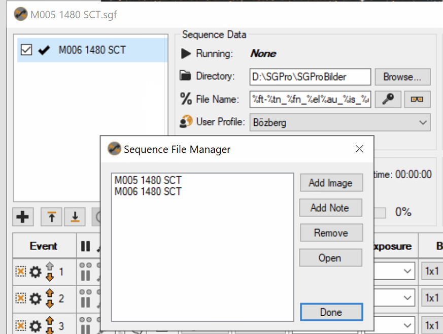

But i’m a litte bit confused about the Framing and Mosaic Wizard and storing the sequences. When i create one and then create another one the name of the first will be placed in the window frame. So when i want to store the new i must use “save as” with a new name otherwise he uses the old. Also the image of the previouse sequence is in the new sequence. And the “normal” file size of about 800kB will be much larger, sometimes more than 2MB.
What make i wrong? How can i reset the previous sequences to get a new clean one?

When creating mosaics they will be created in your current sequence. However you will get the option to either remove the existing targets or add to the current targets. To create a new mosaic you should start with an empty sequence.
