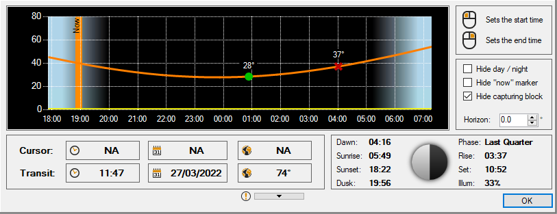

At least the planning tools graph seems to be taking GMT and BST into account
, expect it to have the sunset +1h tomorrow night

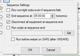

Will it though? As End time goes off current system time correct? So if the system changes from 1AM GMT to 2AM BST at 1AM, then the end time is not based on GMT or BST right, it is based on System Time, so if I set this option:
That’s based on System time, irrelevant of BST or GMT right? Or does it define the end time at the beginning of the sequence?

It worked, setting the end time of 5AM finished at 5AM BST :slight_smile:
