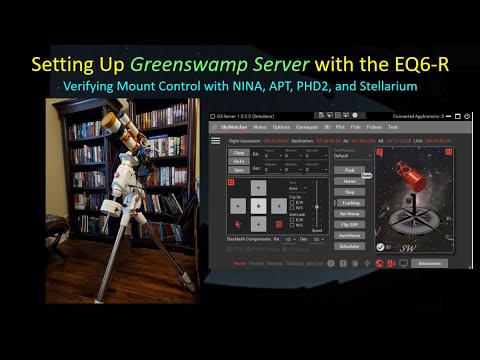

I use an EQ6-R Pro with Green Swamp Server with good success.

It would help me to see how you configured the GSS because this is the first time I’ve used it.
Thank you!
It’s raining and my Mount is sitting outside (protected) while my controlling computer is inside and I can’t show you the parameters without a connection between the two
I would recommend following James Lamb’s setup video here:
I’ll look, thanks!
