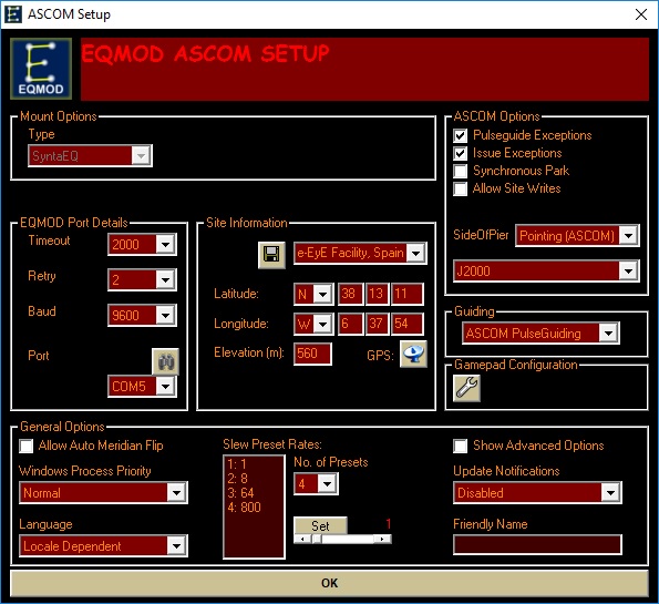

For reference, these are my EQMod 1.28s settings:
To add further information, I’m testing this now after having re-installed and re-configured EQMod 1.28s completely from scratch, with the mount connected to a different USB port. In this re-configuration of EQMod, I have not selected anything for “Timeout”, “Retry” or “Baud Rate” (these options are blank). The rest is configured identically.
PHD2 has reported the same error but the mount remains connected in SGP (for now - hopefully it doesn’t disconnect later). The error seemed to happen after dithering. I have dithering set to “Extreme” and sometimes it autofocuses between frames, so the PHD2 error could just be PHD2 trying to re-center the mount after a few minutes of paused guiding. This would be fine as it doesn’t affect guiding at all and implies that PHD2 is still working well with my mount and EQMod.
Fingers crossed SGP doesn’t disconnect the mount. If it does, I may try SGP 2.6.0.23 (non-Beta) but I’m unsure as to what caused the issue and therefore how to attempt to fix it. Remember, the mount control board and mount Serial-USB cable are completely new and I have successfully used SGP, EQMod and PHD2 together for years with this very same mount!
