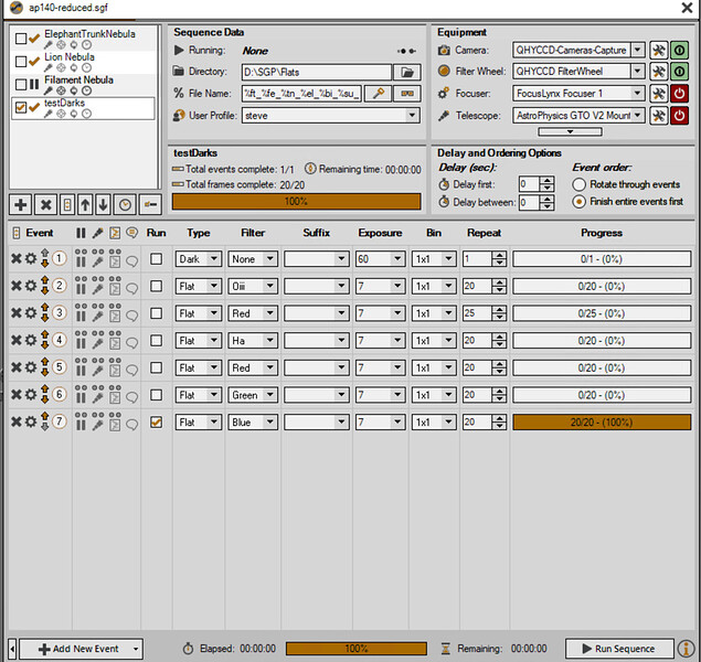

90% of the time there are multiple in the list in the upper left. I am usually working of the last (bottom) target.
When I choose “Run Sequence” the list defaults to the first target in the list which can be confusing at 2AM when I am not at my sharpest.
I would like it to default to the active target, corresponding to the “Run Sequence” chosen.

I am not fully following all of the details here… In the screenshot you have shared, only the testDarks target will ever be considered because the others are unchecked. What do you mean in this context by
In this case, the first is Elephant Trunk but is not considered.
The screenshot is currently displaying the Events associated with the TestDarks target.
When I Run Sequence the Events List reverts to the Events associated with the Unselected “ElephantTrunkNebula”
It is my opinion that the Events list should continue to display the Events associated with the “TestDarks” target after Run Sequence
Oh, ok, I understand what you’re saying. I’ll take a look, but in terms of “feature or bug”, the intent right now is that SGPro shouldn’t alter the view at all… it should be completely decoupled from the sequence and if you want to look at what the sequence is doing “right now”, you click the little clock button under the target list. I’ll check to see if some weird auto select thing snuck in somewhere…
