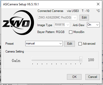

I have verified after applying the setting, going back into camera setting the gain is 100

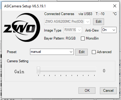

Before setting:

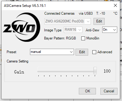

Setting applied:

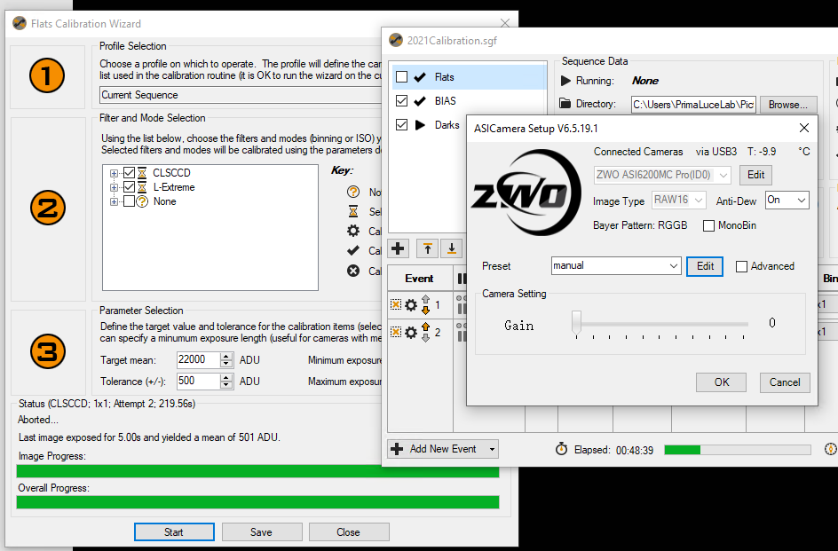

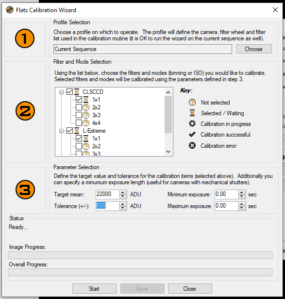

Verified by clicking on OK and going back into camera setting. Then I run the flats wizard and click start

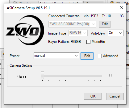

After wizard completes, camera is back at Gain 0 and my calibration was performed at Gain 0 as I noticed it produced the same times as when the camera is at Gain 0
It happens the moment the camera is asked to take the first frame

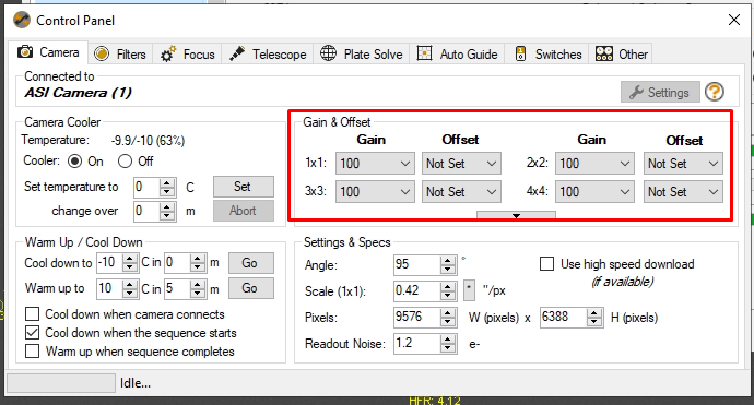

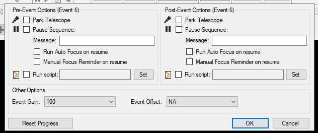

I have also noticed that if in my sequence I have a target that is 100Gain, and I have this set here:
It correctly assigns the gain as 100, as per my expectation. But if the next target does not have a gain setting applied, it remains at 100, so why does that not go back to 0 if the frame and focus and flats calibration wizard force the camera back to 0

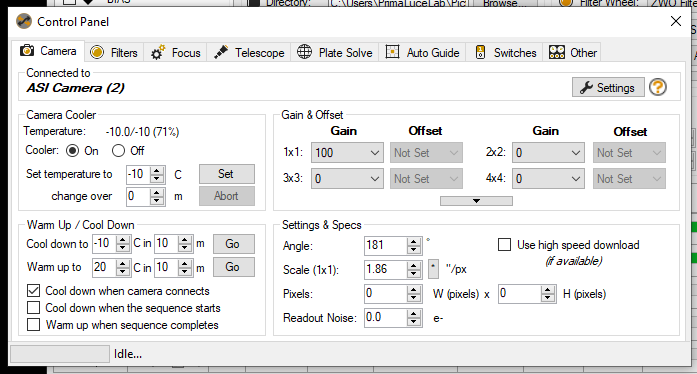

Setting the gain as you set it, will force the camera to go to Gain 100 during Frame and focus and Flats Wizard, then I have the challenge if I want to run the Frame and Focus or Flats Wizard at 0 Gain, so again SGPro is overriding the setting that I have manually applied to the camera
  1. Set the Gain as 100, in control panel as follows:
  2. Set the camera gain to 0 in the ZWO Camera Settings:
  3. Run the Frame and Focus or Flats Wizard, and the camera has been forced to 100 Gain
So the question is why SGPro is forcing the camera gain during Frame and Focus / Flats Calibration (Which leverages the frame and focus routine).
If this is to be, then there should be an option in the Flats Calibration Wizard to set the gain.

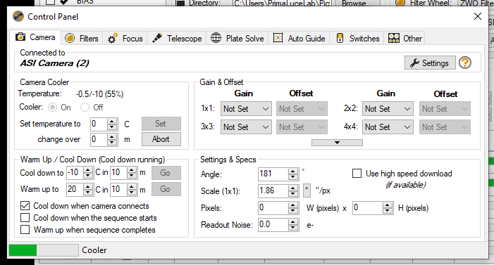

I found the issue
Setting the camera gain setting in control panel to “Not set” means SGPro will not chage the setting during the Frame and Focus / Flats Calibration Routine and will adhere to the gain level I have set manually in the camera settings

I think SGP4 defaults these settings to 0 rather than “Not Set” and that’s what has caught me out with the flats wizard / frame and focus
when I installed SGP 4 with the latest update it reverted the setting to 0 vs not set
