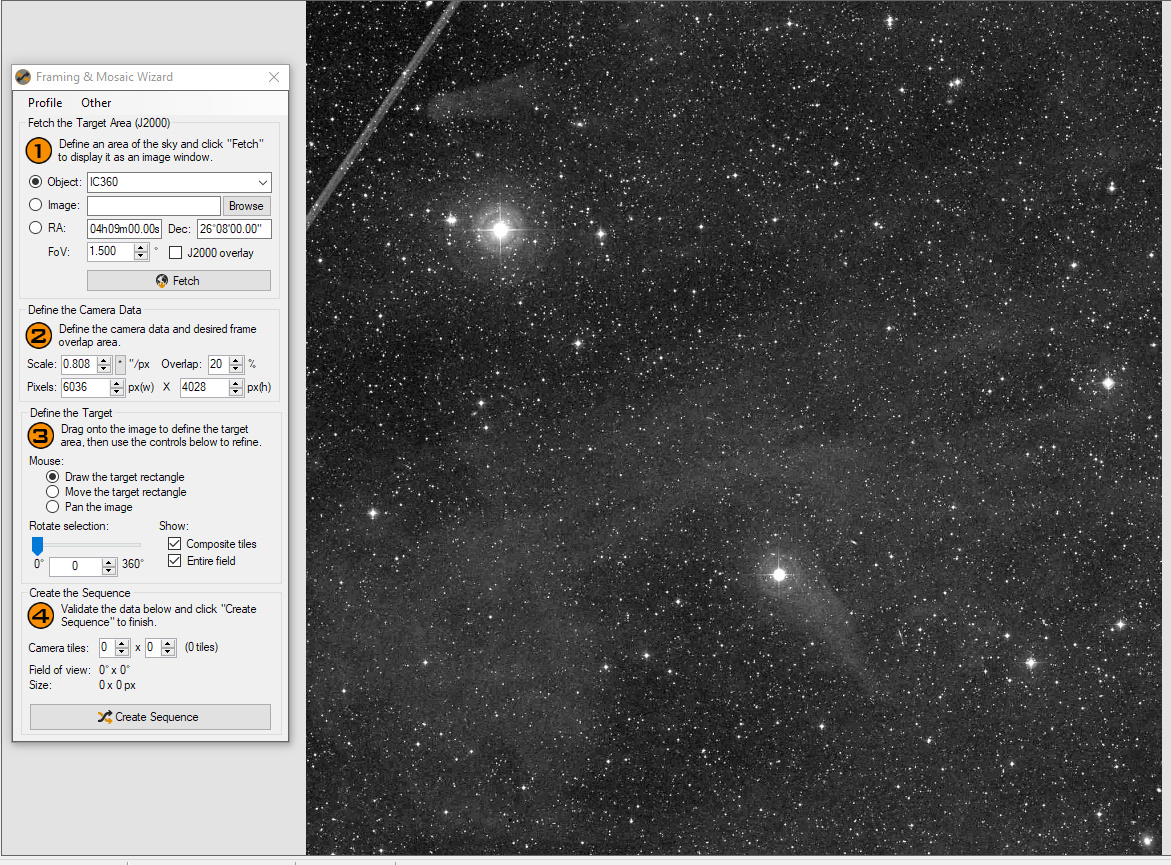

When I use the wizard to find IC360 this is what I get after stretching it:
There’s clearly structure there, but this is a very faint dusty object. With such faint objects you won’t be able to see much from these images.
Thanks for showing this.
I increased the contrast and put down the Gama at my monitor a bit and now it is showing much better very faint objects.
