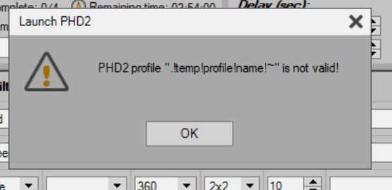

yea getting this error message when i start a sequence. any one know how to fix it?
I have no idea where the weird .!temp came from, but this refers to the PHD2 profile that you have asked SGPro to use when a sequence starts. You should be able to correct it just by going to the setting and selecting a valid PHD2 profile.
First here:
Then click Settings button:
