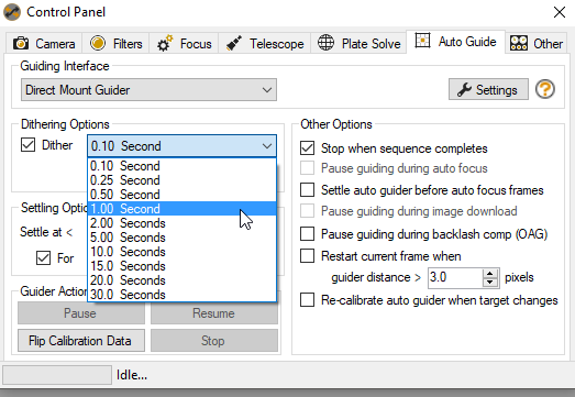

Of course. In fact, if one has a mount that can go for long periods w/o needing to be guided and therefore are able to take unguided images, it is critical to be able to do this. Just select Direct Mount Guider and the amount of dither you want (determine by experimentation).
DMG
Thank you! This will work well for my evening twilight profile after which I can switch to the sequence that has the equipment profile that has the autoguider for my images.
