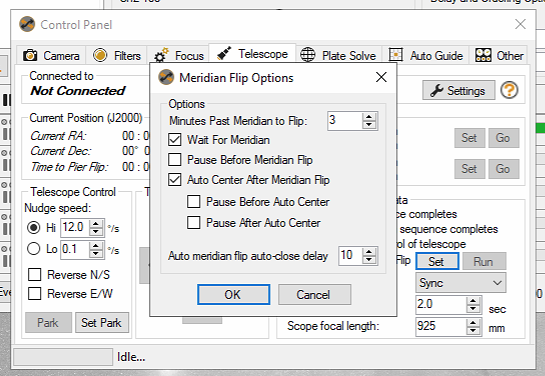

I have the Flip Slew Tolerance set to 3 degrees and Flip Guide Tolerance set to 5 degrees (there are other settings which work with SGP and I’m sure you’ve read them on the 10 Micron Forum). Set to epoch to JNow as this is the mount’s native epoch; J2000 co-ords will be translated on the fly. My SGP flip settings are:

Getting the flip slew and flip guide tolerance set is important as is making sure the number is bigger in SGP flip settings so that when it does send a slew command the mount is already into its flip area of concern.
so i’ve done the typical values of 3 and 5 in the handcontroller, but can you elaborate on what you mean by
i have my settings mimiced from buzz’s above, i was using 10 minutes, but changed it to 3 out of desparation.
