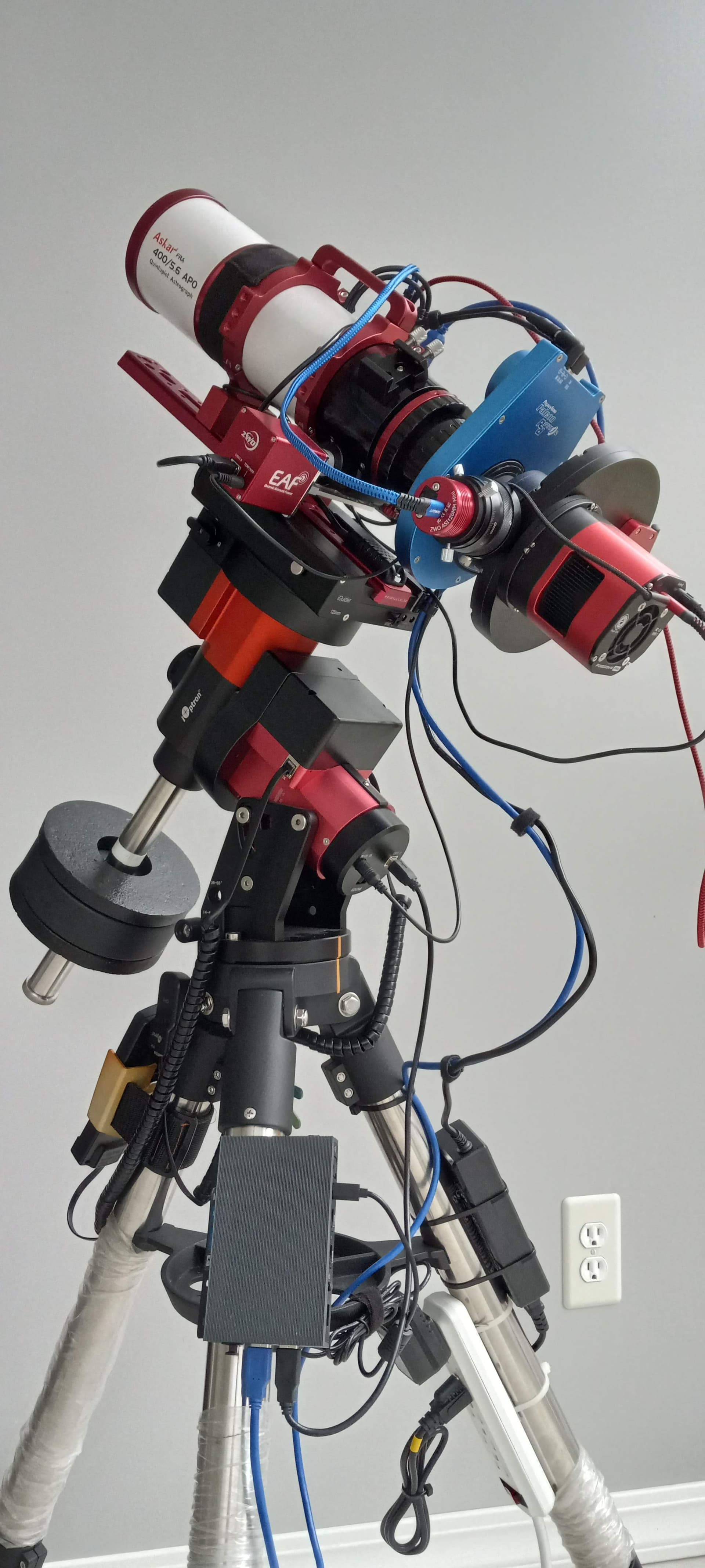

I use the MeLE Quieter3Q mini PC. It came with Windows 11 pro, and have it mounted on the iOptron mount leg. Access is wireless once the PC is setup initially. I use RDP to access the desktop. SGP and all the supporting apps works fine with this setup.

The MeLE has 4xUSB3 ports and 2xHDMI ports. Plus, there is a port for an external micro SD card. I use a Pegasus Astro Pocket Powerbox Advance Gen2 mounted on the OTA and have all the USB and power wiring going to that and then 1 USB3 cable from the Pegasus to the MeLE.
The MeLE I have has 16GB of RAM and 2x250GB internal storage cards. One is for the O/S and apps such as SGP and the other is for storage of the camera capture data. After an imaging session I’ll copy the data to the removable SD card to bring to a separate processing PC.
The MeLE has a built-in antenna. When imaging from home I’ll access the mini PC from the local wireless router. I have a virtual network configured in Windows 11 on the mini PC to act as an AP and can login to and access the mini PC when I’m out in the field (and away from the home router).
Attached is a picture of the portable setup. I keep the OTA w/gear mounted as one unit and just slide it off the mount head after removing 2 cables. This makes take down and setup very easy and fast. The MeLE is mounted on the leg and can rotate depending where in the yard I am setting up so as to maximize the wireless reception from the MeLE to the local AP inside the house.
