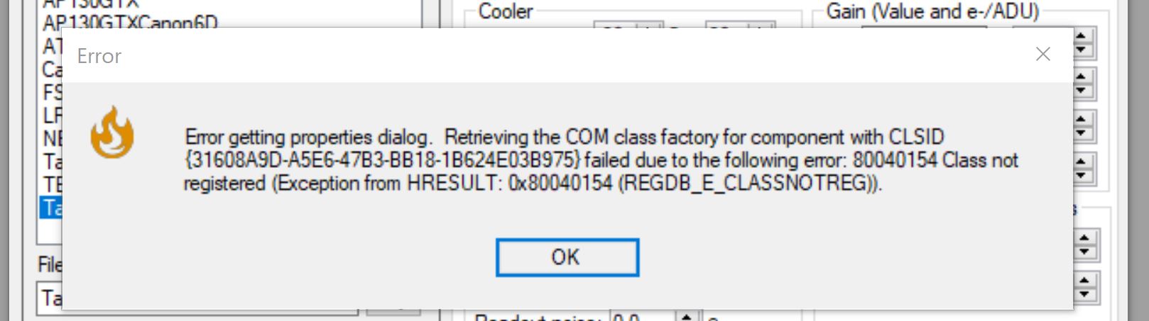

I just acquired a Moravian G4. Upon setting up a new equipment profile, when I try to click Settings for the camera, I get the error, attached.
What should I do?
Shailesh
What should I do?
Shailesh
Did you install the 64bit or 32bit driver? If memory serves you need to install the 32bit driver.
Joel,
Thank you for your prompt reply.
I installed the 64 bit ASOM drivers and when i reverted to 32bit, they install and show up fine. Thanks for your suggestion, it worked!
Awesome, thanks again.
Shailesh
