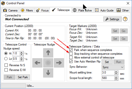

Rather than using these on events you should set the option that will run at end of sequence. A failure will trigger “End of Sequence”:
What’s the difference between doing this in the control panel vs equipment profile manager?
The equipment profile acts as a template for NEW sequences. Once you create a new sequence based on a profile, any changes you make to either the profile or sequence will NOT affect the other. In this case, if you enable these end of sequence options in your existing sequence it will only apply to that sequence. If you update your profile, any NEW sequences you make with that profile will have those options enabled in the new sequence.
Basically, once a sequence is created it stands on its own and is independent of the profile used to create it.
