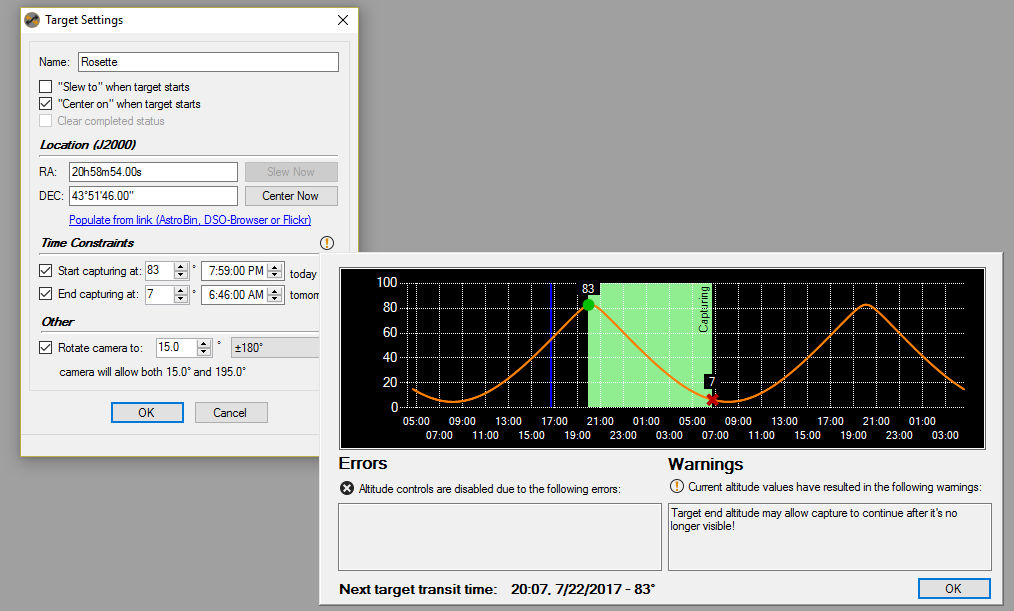

This has been a long requested feature. Still working through bugs, but it’s stating to come together. For a given target, if you have a user profile with valid latitude and longitude (setting this in your mount’s ASCOM driver is not sufficient) and a valid target position in the target settings dialog (RA, DEC), then certain altitude controls will be available. With them, you can:
  • Set target start and end times, as normal, and see what altitude those times correspond to
  • Set target start and stop altitudes and see what times those altitudes correspond with
  • View errors and warning associated with those settings
  • View the target’s next transit (+/- 5 min… not great for science, but likely good enough for SGPro)
  • View a graph that shows the target altitude, over time
  • The green dot shows start time / altitude
  • The red X graph shows end time / altitude
  • The vertical blue line is “now”
  • The shaded green area shows the time frame for which this target is allowed to capture

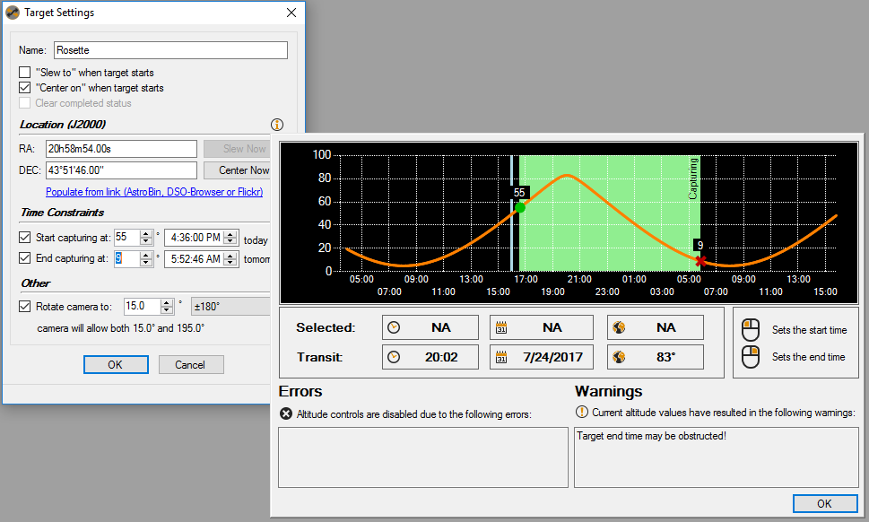

Alright… here is the version that will be released in the next beta:
Thoughts are welcome.
I think it turned out OK. We had to go ahead and implement start/ end time selection by clicking the graph because it seemed like the best solution to decoding user intent. If you enter an altitude, SGPro does not which side of the meridian you mean (we could add E / W stuff, but the graph seems more elegant). You can adjust target start / end times by using the numeric and date controls (even while the graph is open) or you can click the graph. It’s pretty flexible and, with it, you can:
  • Set target start and end times (from target settings), as normal, and see what altitude those times correspond to. This does not need the new visual aids. It works just by updating the times in the form.
  • Set target start and stop altitudes and see what times those altitudes correspond with. This does not need the new visual aids. It works just by updating the altitudes in the form.
With the new visual aids, click on the “i” next to the “Location” section, you can:
  • View target ephemeris graph showing the target altitude, over time
  • View capture time markers:
  • The vertical white line is “now”
  • You can now left click on the graph to select a new target start time
  • Right click on the graph to select a new target end time
  • View errors and warning associated with current settings
  • No lat / long set error
  • Target has an invalid location error
  • Desired altitude is below the horizon warning
  • Desired altitude is low warning
  • View the target’s next transit time and altitude (+/- 2 min)
