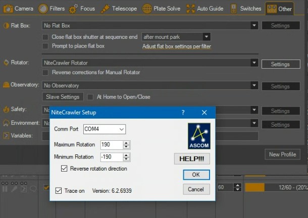

I’m having what might seem like an old problem that’s been solved for others before, but after trying all the solutions I could find, I’m still not having any luck getting my NiteCrawler 2.5 rotator to rotate properly and center after initially finding its target, and it’s only going in one direction.
Before I get into it, I’d like to share that I do have the rotator set to reverse direction and the limits set to 190/-190.
NCsgp-2

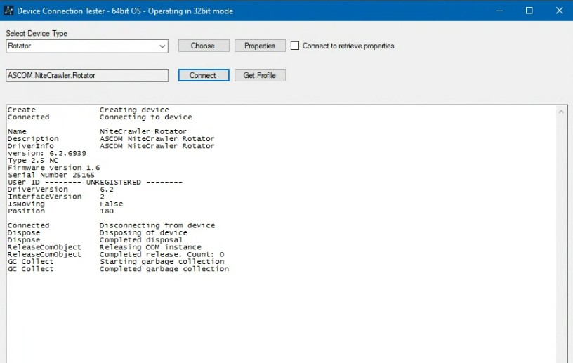

I’m running ascom 6.6 SP1
Here’s a screenshot of the ascom diagnostics of the rotator

SGPro has no control over directionality. In the contract that ASCOM provides, it allows an app like SGPro to ask for a position only and then lets the driver itself determine the best direction to get there. In other words, if this is not already a setting in the ASCOM driver, it would need to be a request to Moonlite.
The logs you have posted do not have any specific errors I can see, but I do see the long hang period where you eventually decided to abort while awaiting rotation to complete. Not being present, I don’t have to corresponding visual to correlate with the logs.
