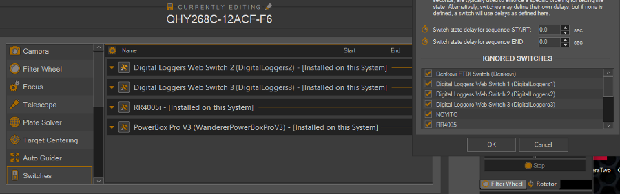

I have been away from imaging for a while but in preparation to resume, I downloaded v4.5.0.1534 and began configuring it for my new gear. I am having problems defining switches. I have several ASCOM switches in my ASCOM Profile but they are being used by other ASCOM software. I don’t want SGPro accessing any of them.
I followed the procedure for marking switches to be ignored and marked all to be ignored. However, some still show up.
Not sure how to proceed.
I’ll take a look here… a bug has crept into the ignore list, but it seems to affect only profiles. In other words, go ahead and keep the profiles switch list in the state that you want (because I’ll fix it). When you use it to make a sequence, the new sequence will essentially fail to honor this list. Now, from the sequence, open the same dialog and “re-ignore” the switches. The sequence itself seems to honor the list. I’ll take a look at profiles.
