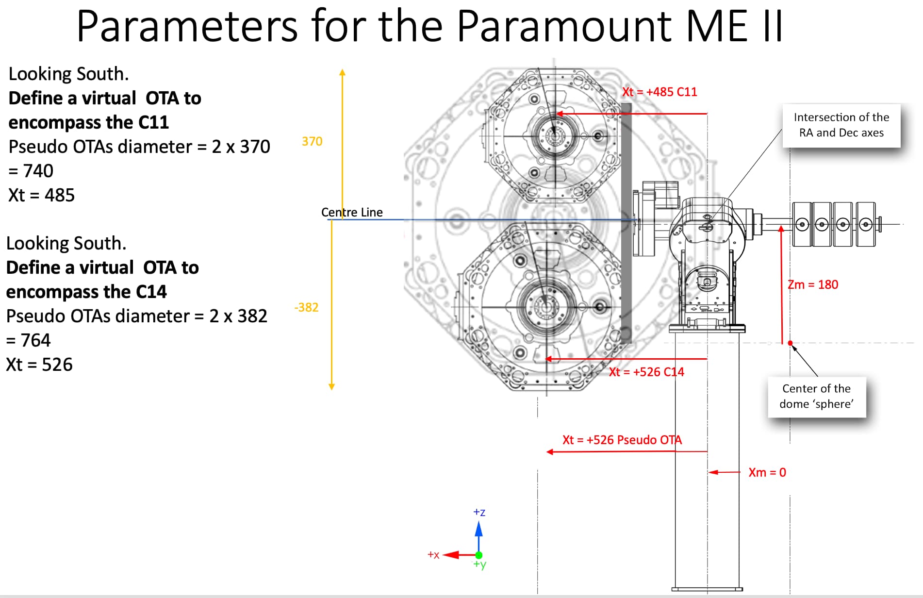

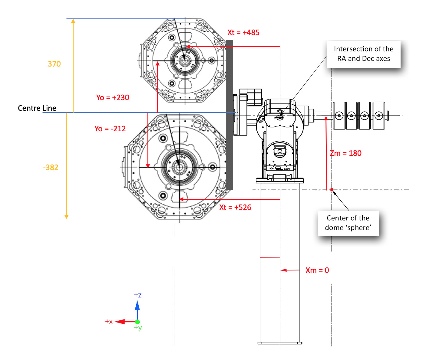

I have recently upgraded my set up, to have two OTAs on a single Paramount ME II Mount. In TheSkyX, there are a number of geometry parameters to be entered to ensure that the OTA is pointing at the opening in the dome. In general, these parameters are mirrored in the Observatory Settings dialogue box in SGP. However, one that is not is the offset between the axis of one or other of the OTAs and the Declination axis.
This is the parameter Yo in the attached diagram.

Hi Chris, yes I can do that. i.e. have two profiles where the dome geometry parameters are different. The problem is that I don’t have anywhere to enter a parameter that takes into account, the fact that the two OTAs are offset from the Dec axis. On TheSkyX, when I have the Yo parameter set at +230, the C11 points correctly, but the C14 does not. However, when I set Yo to -212 for the C14, it points more centrally at the opening.
I don’t know how complicated the mathematics are to incorporate this parameter, but it would be very useful, since I am not the only one with side by side mounted OTAs. As a last resort I will define a virtual OTA, which has a diameter to include both OTAs. However that virtual OTA will have a diameter of 2 x 382 = 764mm and the opening is only 1000mm wide, so it is tight.
Any other ideas?
Cheers, Niall

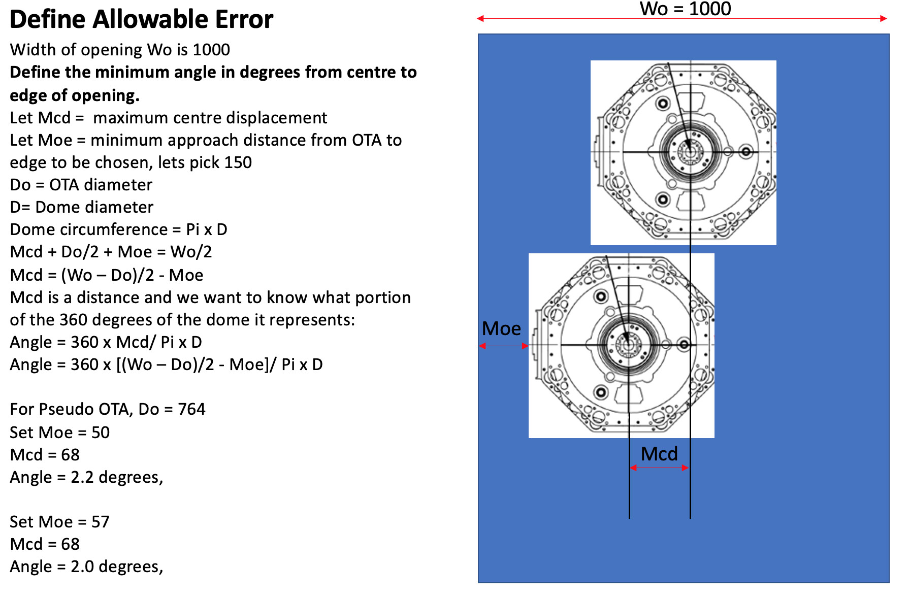

just a thought - is your shutter wide enough to create one BIG virtual telescope geometry that copes with either?
Thanks Terry, I have done some trials with the virtual scope and they work. It helps that the C11 is smaller within the virtual scope. I may have occasion to image through both and that is when it will be the most critical.
Hi Chris,
Yes it is and I have done that.
Here are the parameters for the allowable error:
I created the virtual scope along the lines I described. Unfortunately, I’ve just discovered that there are positions where the C11 is being partially occluded by the dome.
