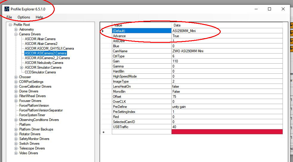

@Jared , @ChromeSurfer Renaming ZWO Camera 1 Camera 2 for ASCOM, the easiest way is to under the start menu, scroll to ASCOM, then select “Profile Explorer.” It resembles the system registry. (see the screenshots). Select the Camera Drivers. BE sure to select the right Camera 1 or 2 for the camera you are naming, select that camera. On the right, first line is Default. Just type in the name of what you want your camera named. Close profile explorer, open up any app that you can select your ASCOM camera (SGP PHD etc) and the new names will be there for easy ID. I also changed the FW name also! Again see screen caps. You will NEED to go under Equipment Profiles and change your camera to the new name. Otherwise it will be listed as “No Camera”

Thanks @Bos ! I saw those settings before, but I was tentative to change them because I thought it might mess something up.

Thanks Bos, That’s great - I did try to edit the names once but then things stopped working. I’ll try again and this time edit the equipment profile within SGP too.
I have 4 ASI cameras though (a 2600MCP - with a 5x2" filter wheel, a 290 mm mini for guiding, another 290 mm for planetary and also 120 mm for guiding) . Do you know if I can set up additional drivers for the 290 mm and its filter wheel? Not all are connected at the same time of course so it may not be necessary but it would simplify things if I could. Thanks… John
