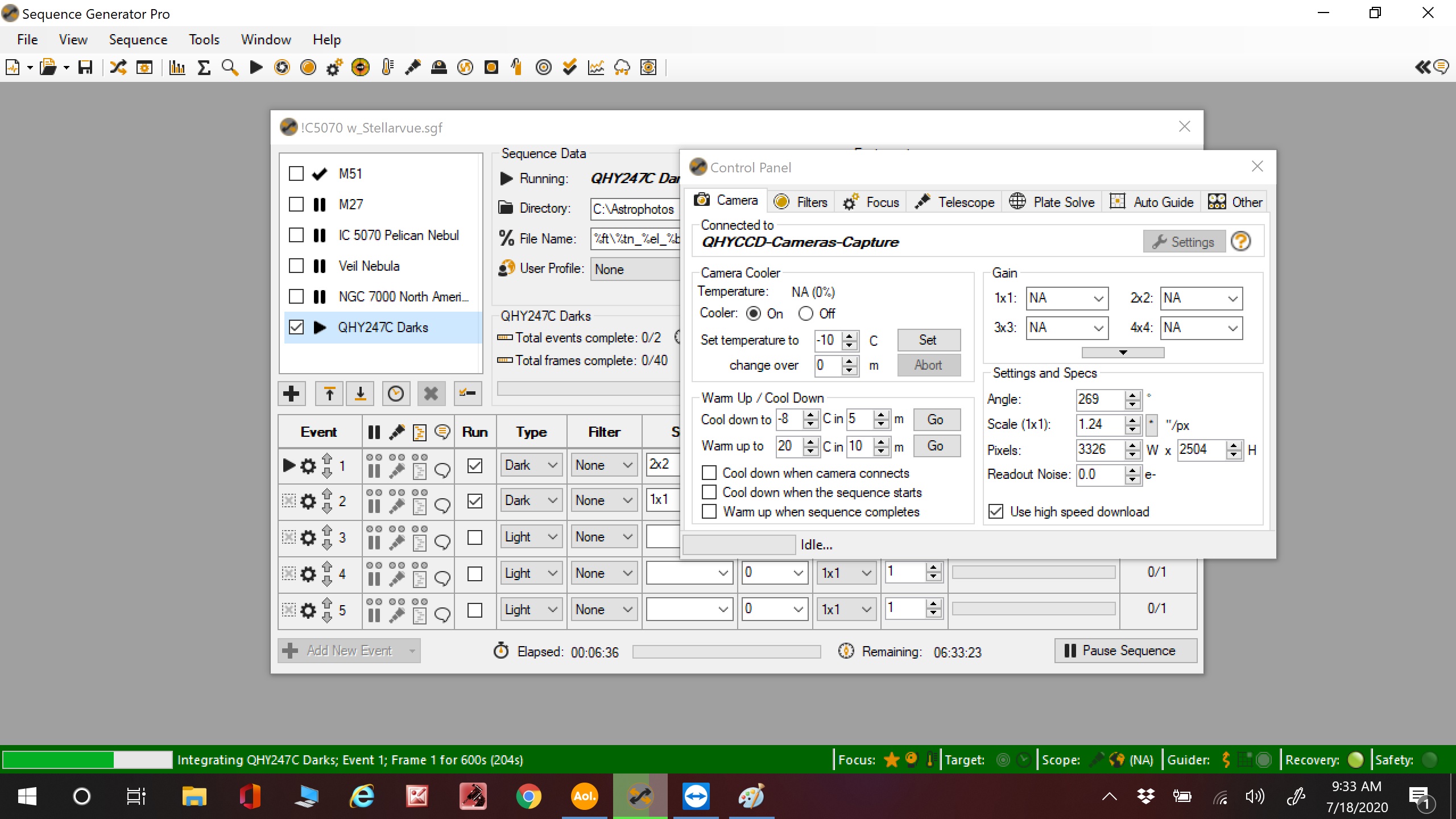

The cooler in my QHY247C camera does not seem to be working with SGP. I think the camera is OK.
I have a QHY247C and it works fine with SGP. In the dialog above, you have not told it to go… either with the cool down on camera connect/sequence start, or the SET button next to -10C
