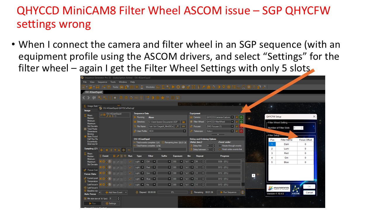

I am having a very similar issue with the QHYCCD MiniCAM8 I just bought. It is their integrated mono camera and an eight slot filter wheel.

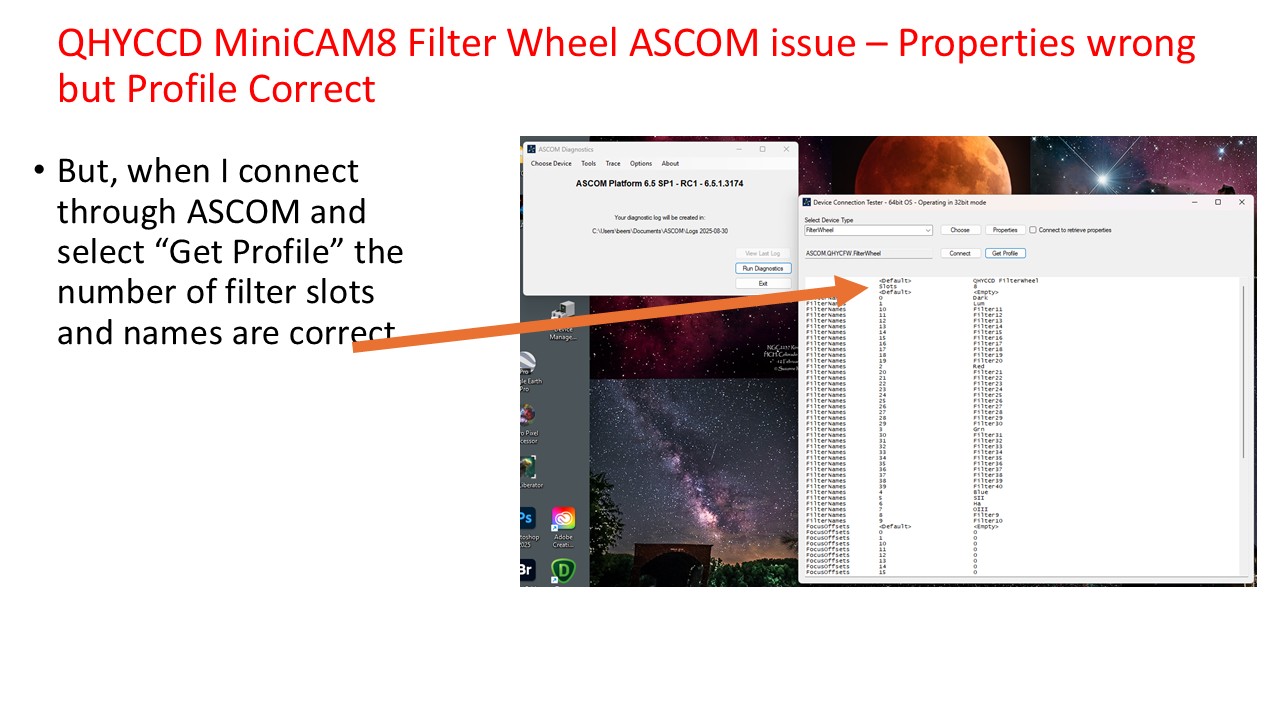

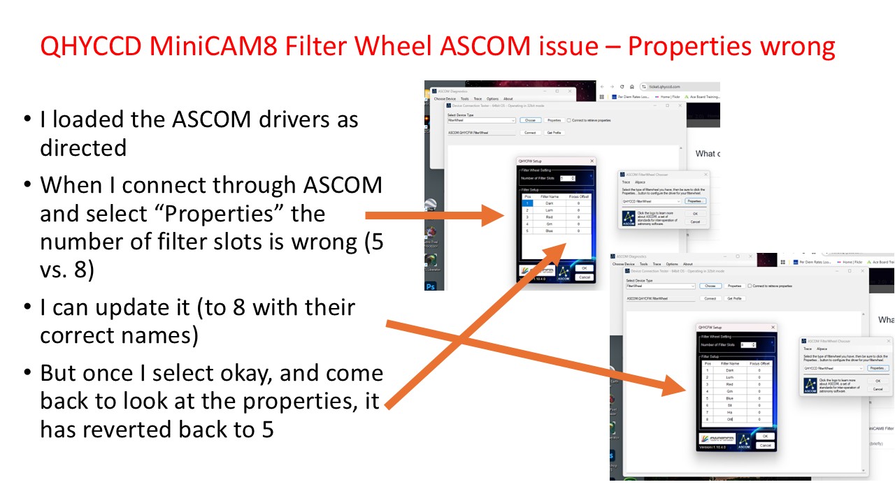

In my case, the ASCOM profile is showing the correct number (8) of slots and I went in through the profile explorer to name the filters in each slot…that is correct, but the profile doesn’t seem to transfer over to the properties, which continues to show 5 in both ASCOM and when SGP calls ASCOM.
I’ve attached the screenshots I submitted to QHY Ticket center last night illustrating my problem.

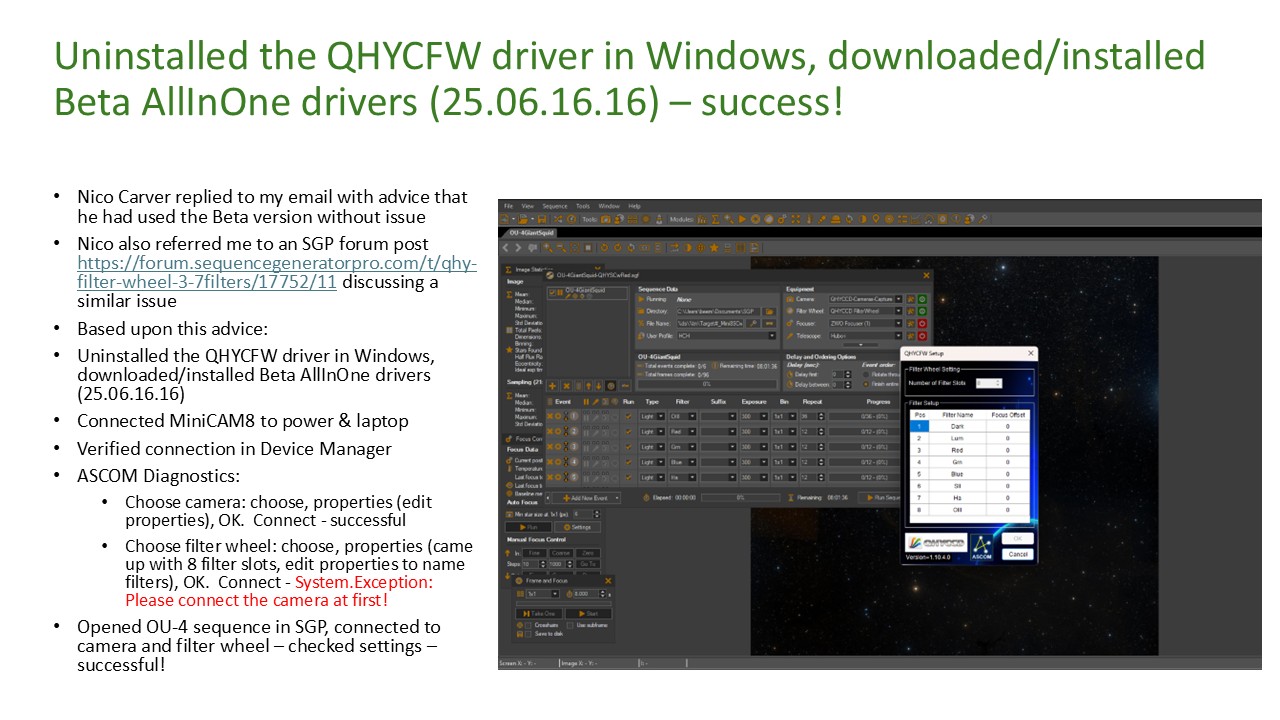

I think I’m going to give the latest Beta version of the AllInOne drivers a try (since the stable 12.27.2024 version doesn’t seem to be working anyway.)

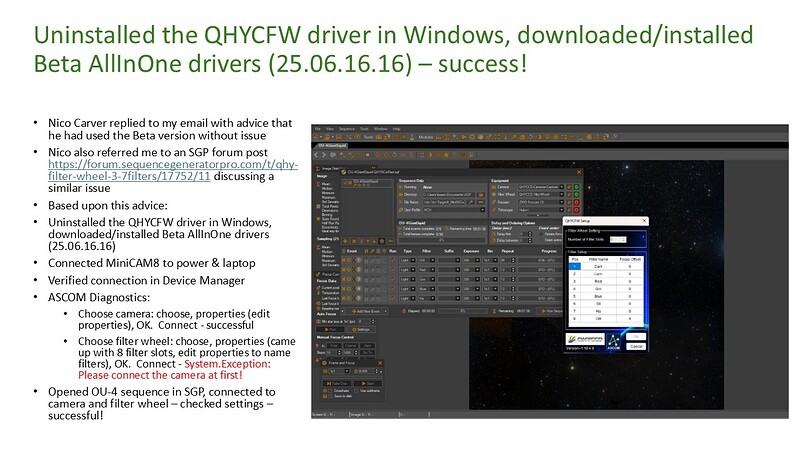

Nico Carver pointed me to this conversation and told me he’d used the Beta version successfully, so I used the advice chasmiller46 got from QHY (uninstalling with Windows). Then downloaded and installed the Beta version of the AllInOne drivers. It worked!
Excited to try out my new camera tonight!! Thanks for the conversation and advice!!

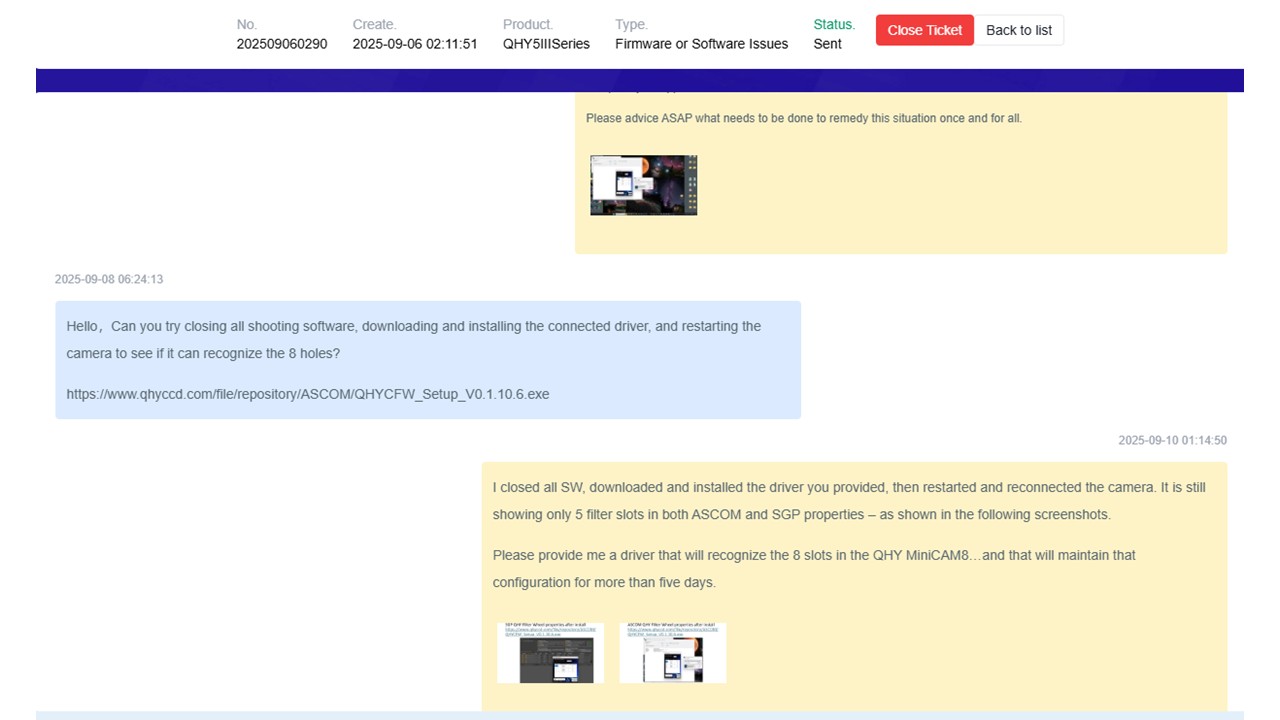

Update on this issue - after I loaded the QHY AllinOne Beta version on 31Aug2025, it recognized the correct filter wheel configuration. I imaged with it successfully on 1Sep2025. On Friday, 5Sep2025, I powered up the rig to capture flat frames during the mid-afternoon - the 8 filter wheel slots were still recognized in both ASCOM and SGP. Later that evening, I powered up the rig again to capture dark frames - the configuration had reverted to 5 slots!! I got a similar response from QHY with a link to a “new” driver. Installed that as instructed (including uninstalling the existing driver through Windows) which again only recognized 5 slots in the filter wheel.
When I make the change in the ASCOM Profile Explorer, it doesn’t stay changed…
I’ve been going back and forth with QHY Trouble Center and contacted Agena Astro (where I bought the camera)…all to no avail. I’m about ready to return the product. While I really like the mono camera with built in filter wheel idea - this implementation is too frustrating!
Any last minute suggestions before I pull the trigger on asking for an RMA from Agena Astro??
After running me through the above USB connection “work-around” to no avail, they said it is a “hardware issue.” I posted this in response, noting
