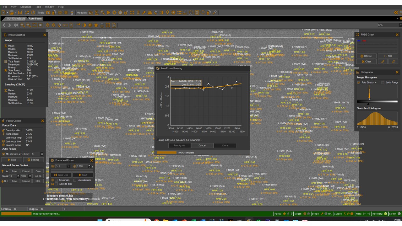

Last night when I attempted to image with the new QHYCCD MiniCAM8, I was unable to achieve focus. Attached is a screenshot from one of the autofocus runs (SGP, ZWO EAF) that shows the issue I ran into. I spent over 3 hours, trying to manually focus and running the autofocus routine in SGP - using different CFW filters, changing the binning and exposure time of the focus image, and changing (radically) the focuser position, all to no avail.
  1. The image captured is very bright (i.e., usually indicating the imaging train is severely out of focus)
  2. The EAF was picking up on “stars” and returning different number of stars, but similar HFR values regardless of where the focuser was located throughout its length of travel (i.e., the same result at “0” and at 7cm

It’s hard to tell, but is SGPro actually finding stars in the data? In your message above you put stars in quotes so Im not entirely sure. In other words, just with a visual eyeball inspection does it look like SGPro is finding real stars or finding bright noise?
Once you are certain that you are obtaining measurable data, you can move on to the next step. That graph you posted above means one of 2 things:
  • Your focuser is not moving enough to change focus in a measurable way (most likely)
  • Your focus is bound mechanically or gravitationally (camera too heavy etc) (less likely)

To answer your “is SGPro seeing real stars or noise” - that’s exactly what I don’t know! The image was so bright and grainy (what I’m accustomed to seeing when the camera is out of focus) throughout the full range of the focuser movement with multiple different filters selected…I don’t know what it is calling a star and using for the number of stars and HFR calculations.

you can also try slewing to a bright start, moving the focuser to 0, selecting a 5-ish second “Frame and Focus” exposure binned 2x2, then press “Start”. After each exposure move the focuser out 1000 steps until you’ve moved it all the way out (adjust the 1000 steps so that you move the focuser around 10 times).
If your histogram is like it is in your screenshot, decrease the exposure time. The image may be too bright not because it’s out of focus but because the exposure time is too long (or both).
If you never see starts, does the manufacture have a Windows program that you can test the camera with? It’s possible the camera is misconfigured in SGP.
