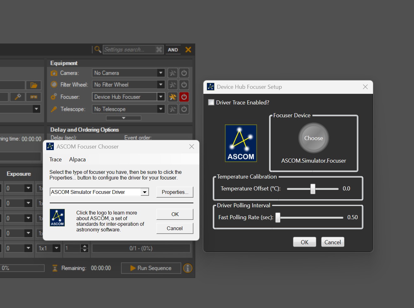

Use Device Hub for the focuser. (The image is from my desktop….not the Obs computer….so does not show the RoboFocus option in the drop down…..but yours should if the Ascom driver is installed OK)
Thank you!
