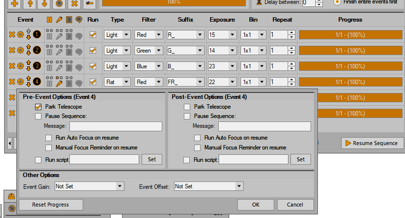

before I take flats I set a pre-event to park the telescope. But while the first flat is integrating the rotator is still rotating. Is there a way to add a delay before the flats start integration? Or maybe the integration waits until the rotator is no longer moving.

  3. I sent a screen shot of the pre-event dialog to show that there is no input field to set a time delay. I also assumed that SGP will completely park the telescope and wait for the rotator to stop before it continues the sequence.
