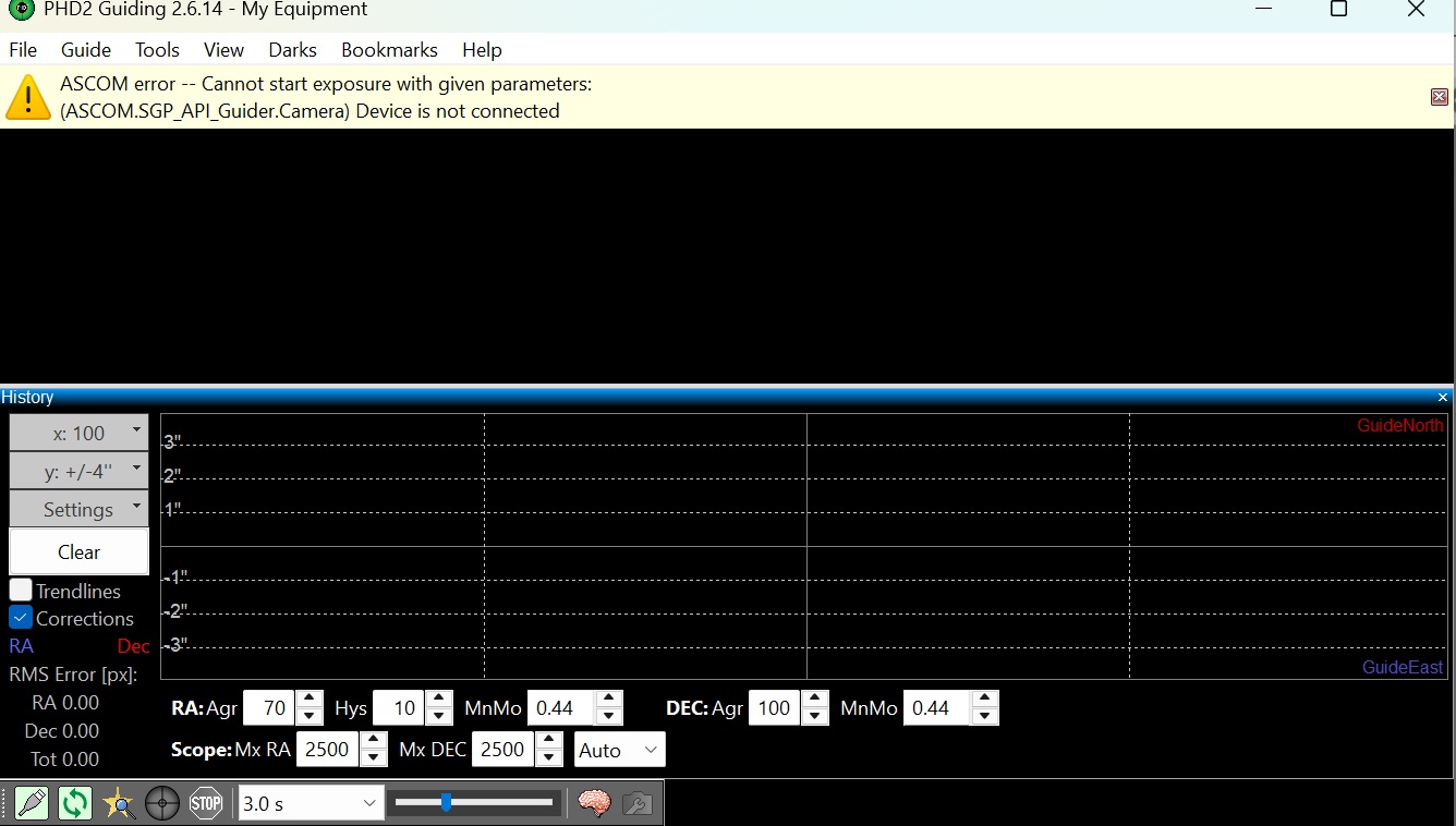

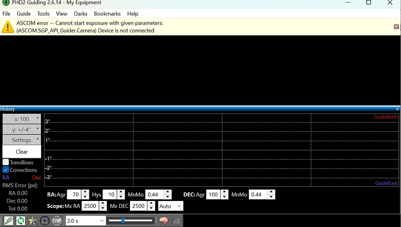

Ive got an stt 8300m with self guiding filter wheel. I downloaded the SGPro API Guider and i still get this error message. Any help? thanks

Is the SBIG camera configured properly in SGPro?
Did you make sure that SGPro had a connection to the camera before attempting to loop in PHD2? In the logs provided there is no attempt to connect the camera in SGPro but maybe the wrong logs were sent.
yea im a complete newb to SGP. how do you even take a picture to see if its working? also i keep getting this pinpoint error “pinpoint le is licensed only for use within maxim dl and maxpoint”
i made sure all the equipment was connected then i connected PHD 2. im still getting the error. those were the right logs though.
