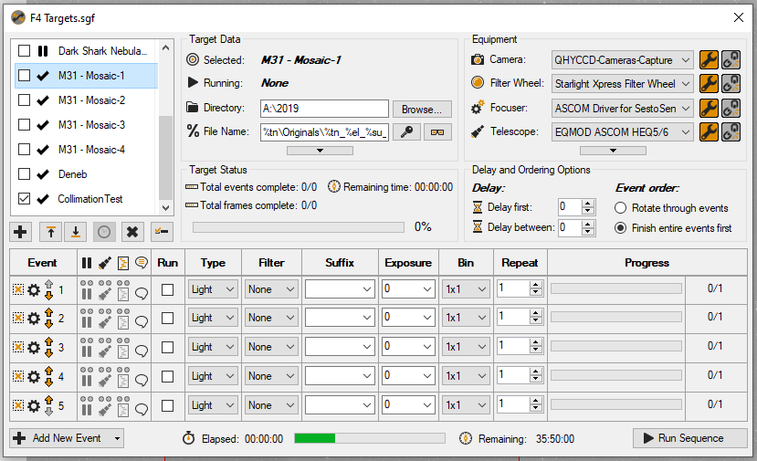

I upgraded to 254 this afternoon and in my sequence some of my targets had lost all filter target information as well as duration and number of frames…weird
You can see here, my M31 Mosaic frames have all been cleared out
@STAstro
Did do anything between starting SGPro and selecting the “M31-Mosaic-1” target?

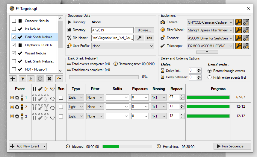

No Nothing, after the upgrade I started SGPro, and it loaded my previous Sequence, and some of the targets were misssing the information, some targets were also displaying for example 32 frames total, because it had completed 32 out of 51, but the total was now 32 also
Upgrade to .272 also did the same thing, Prior to the update I had 12/51 for both Green and Blue, now it has cleared out the filters, duration and exposures again!!!
It has cleared out all my other targets too
@STAstro
Would you be able to send me the sequence you are using in the screenshot above?
