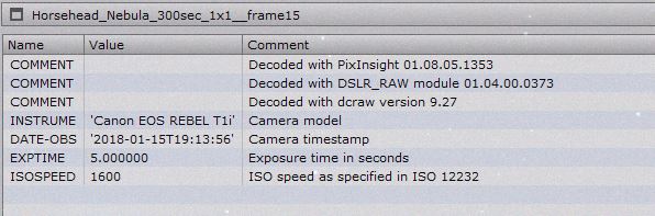

This is actually a 5sec exposure at ISO 1600:
Header
Kind regards,
Horia
I wonder how so? I had SGP sequencer set to take 300 sec exposure and I saw it count off to 300 secs. Where else in SGP would you set the exposure time? I did have the mirror settle time set to 5 secs. Would that be my error?
I’m confused now
Exposure duration is set in the sequence, in the column that is headed ‘exposure’
Settle time should not affect it other than a slight delay before the start.
Download speed wont effect it either. Many have issues with ‘high speed download’ in fact.

Hi cap_stone,
SGP can’t control whether mirror lock is on, so if you set a mirror lock exposure time of 5 sec without mirror lock being on it will take a shot for 5 secs. With lower level canon cams you cant enable mirror lock so the solution is to not use mirror lock at all. Hope this helps!
