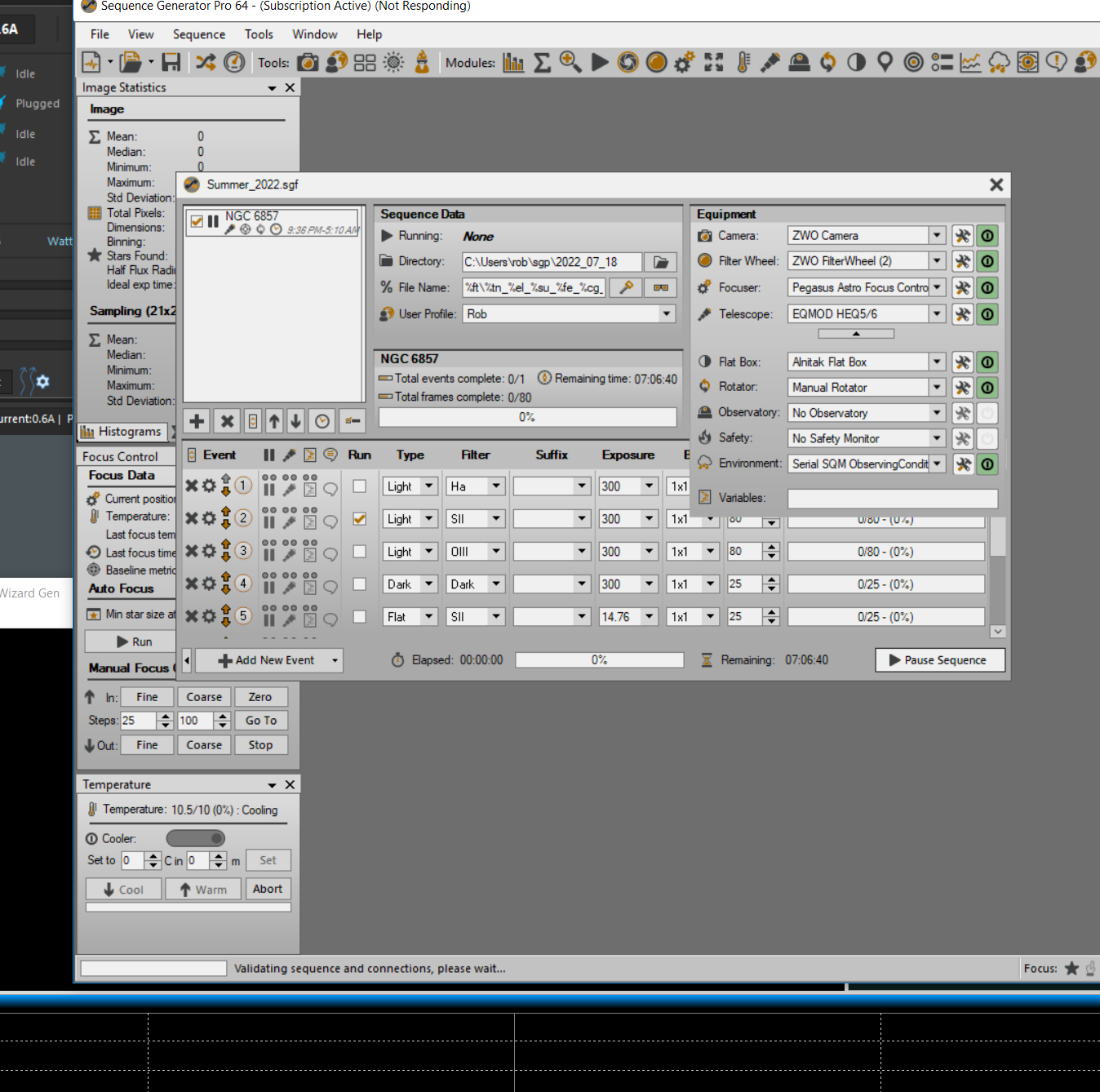

I was using beta4.2.0.852 and had sgp crash after frame and focus. I saw that x855 fixed that, so installed it, and afterwards frame and focus then worked fine. However, when I run my sequence, it hangs sgp with the message:
“Validating sequence and connections, please wait …”
The only thing I can do is force-close the application - it’s totally hung.

screenshot:
