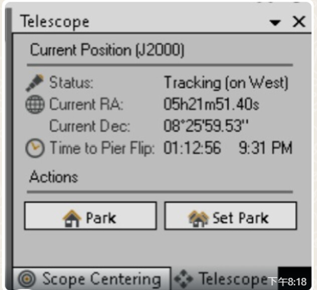

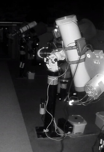

20:15 : When the OTA is pointing East (OTA on West), it works fine, doing capturing until the flip time 21:31:

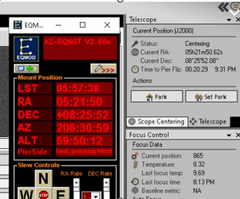

21:08 : it flipped before the anticipated flip time.
In the telescope ASCOM driver EQMOD, it shows as OTA on East side, pointing West.
In SGP, it shows still 20min to the flip

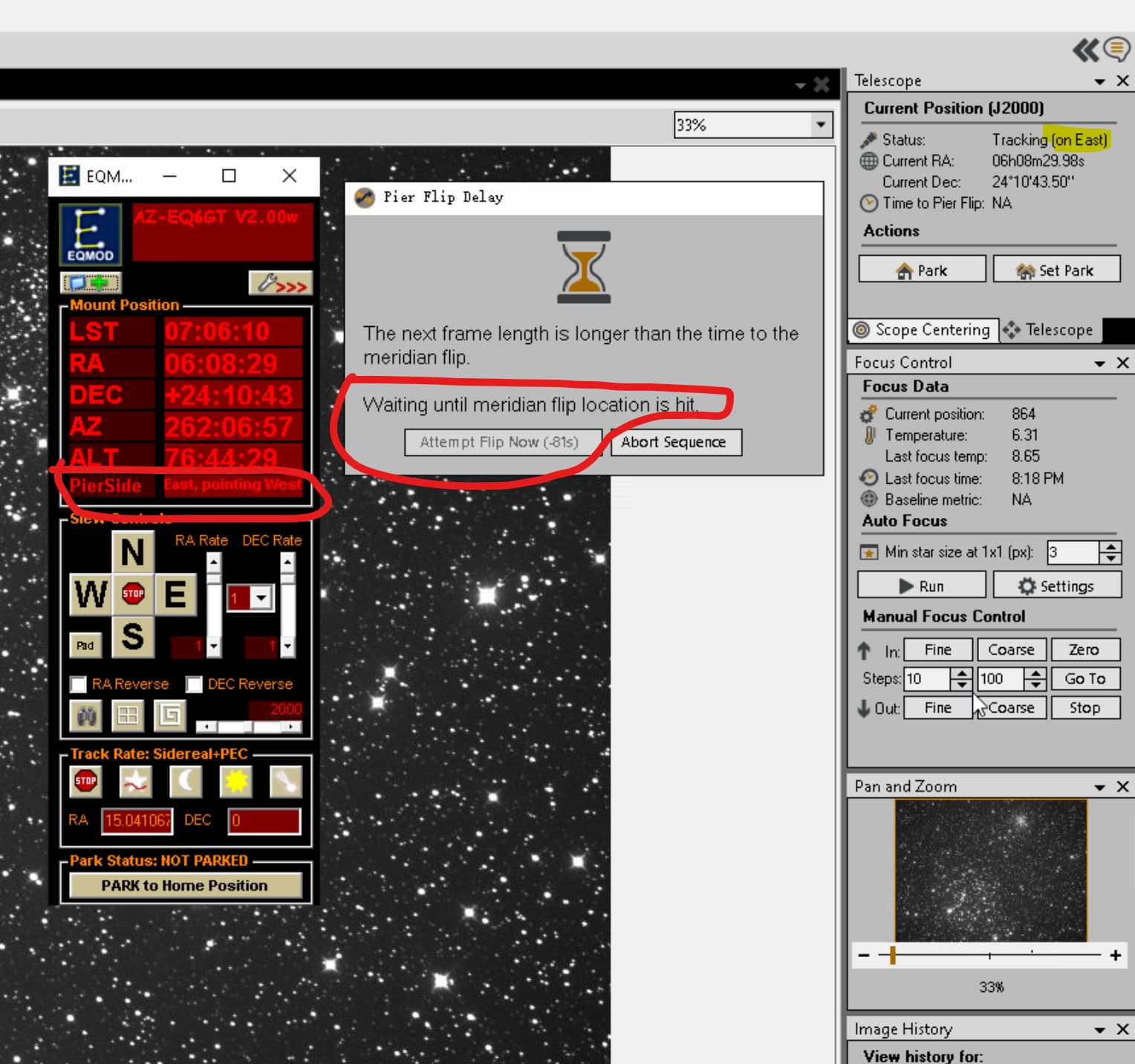

The OTA is already flipped physically, pointing West:

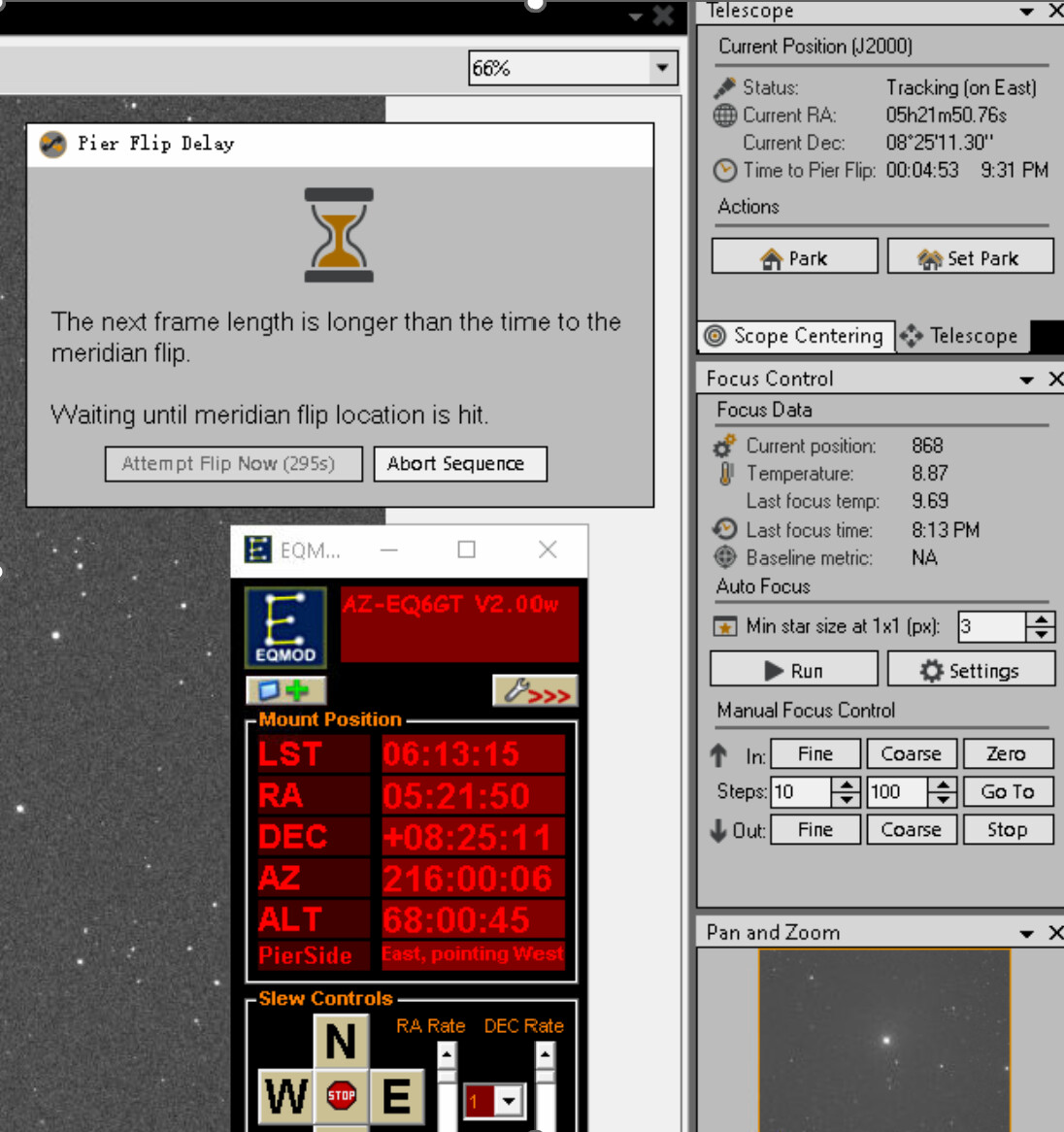

21:26 : SGP dialog box tells, it is waiting for the Flip:
The OTA is already on the East, pointing West, there is no need to wait for, or to do a meridian flip.

It waits forever for meridian flip, even when the OTA is on the East side of the pier, the waiting time is also turning to negative value:

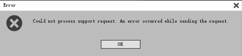

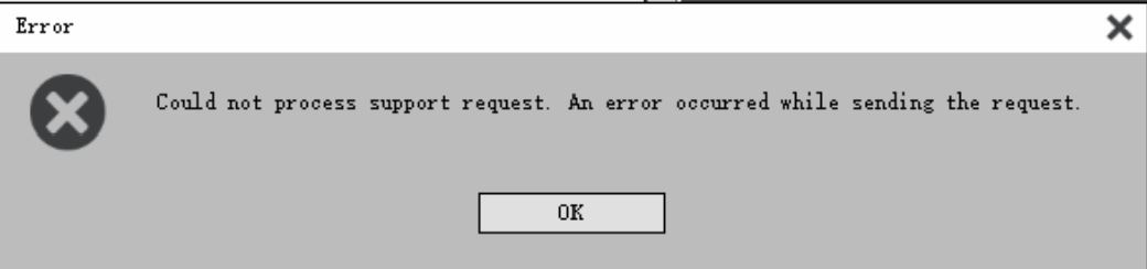

I tried to submit the log via the SGP’s problem report function, but can’t, may be due to network issue from that PC.
Please see if you can take the log from the google drive attached.
