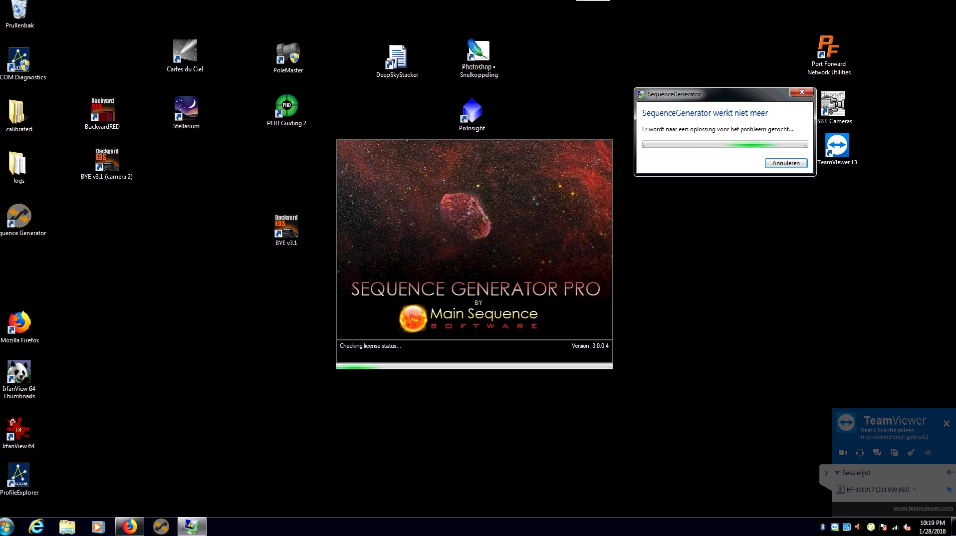

when i reinstall version 2.6.0.24 everything works fine.
Installing SgPro 3.0 again gives the error again : see screenshot.
