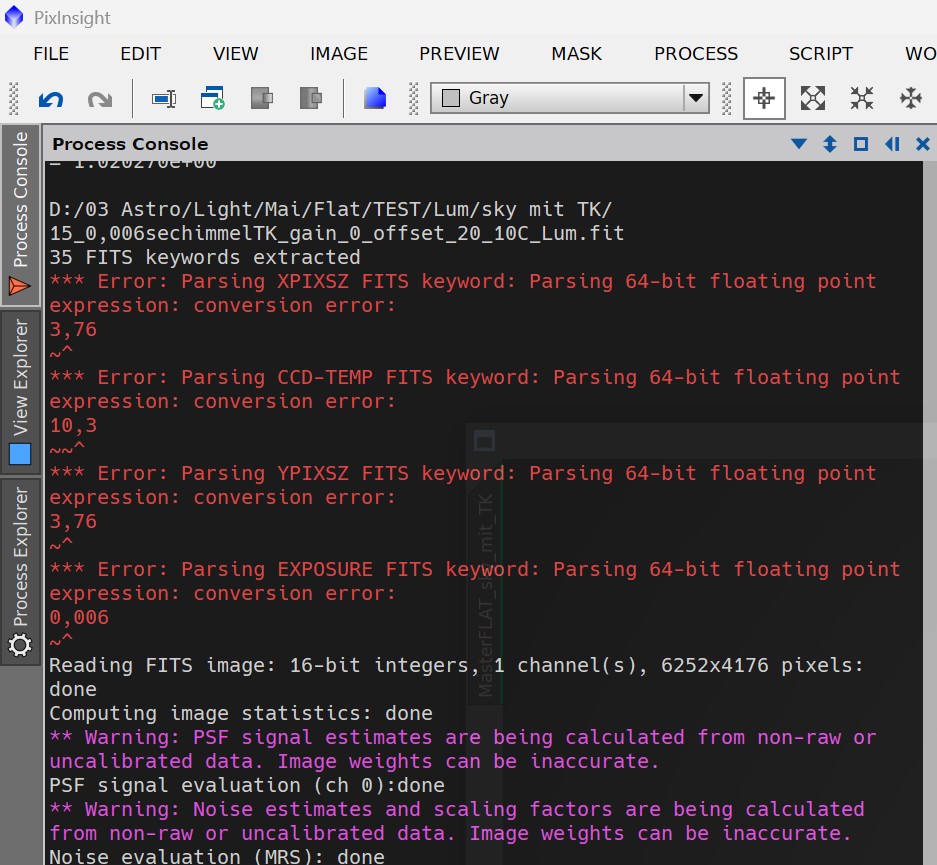

Looks like a problem with using a comma for decimal point.
Look at the fits header for an image that gives the error message, and for an image that does NOT give the error.

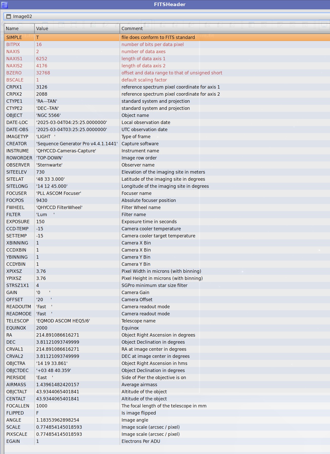

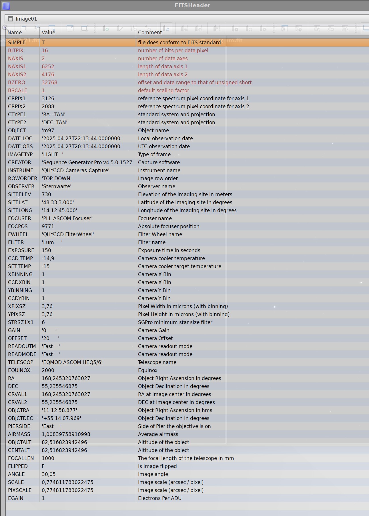

I checked the FITS header.
Previously, the pixel size read: 3.76
Now it says: 3,76

Attached are the FITS headers for the current and beta versions.
In the beta version, XPIXSZ and YPIXSZ has a “,” and in the previous version, it has a “.”
Also OBJCTALT and so forth
