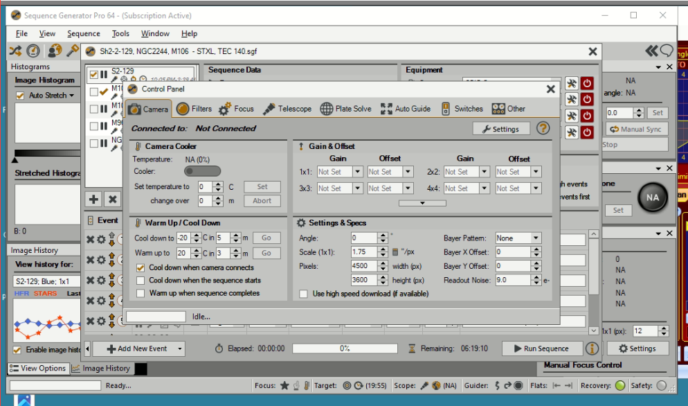

Just installed beta 4.3.0.1154 64-bit.
First AND second time it looked like this:
After first time I enlarged and moved the main window to bottom left, put the control panel above it, and enlarged and moved the sequencer to the right of the main window. But 2nd time windows were in the initial position.
3rd AND 4th times I got this, again, all in the upper left:
Interesting that after the first time I cleared the Image History, but it was still there in the 3rd time. I cleared it again and the 4th time it was gone.
If it makes any difference, all I did for these tests was started SGP, moved/resized the windows, and exited. Then restarted, etc. I did NOT connect any equipment or do anything else.
