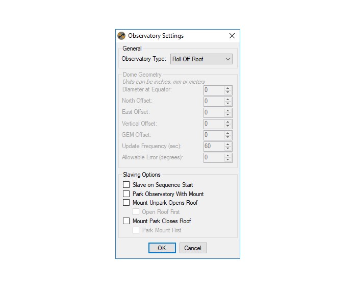

Hi Chris,
What kind of slave settings do you use for SkyRoof?
Kerry
