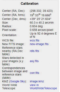

Early this morning (still very dark), I pointed at Vega. Followed your steps and took a 30 sec “Take One” image. Saved it to disk and then uploaded. Astrometry.Net came back with the following calibration data.

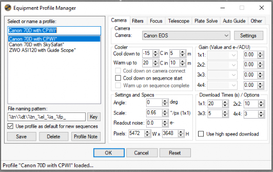

Entered that into the equip profile (it was already correct):

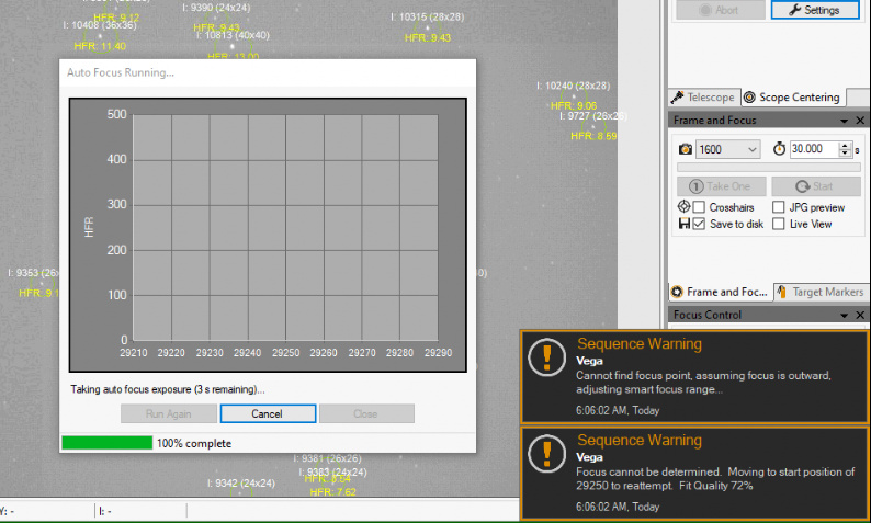

Launched the “Solve and Sync” … it failed to solve and rolled over to “Blind”. It solved, ran through the auto focus and had issues.
I never did get Vega properly centered.

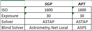

I then switched over to the APT app and tried the same process. Here are my comparative settings:
I ran a similar scope centering process and it finished successfully in about 5 minutes.
