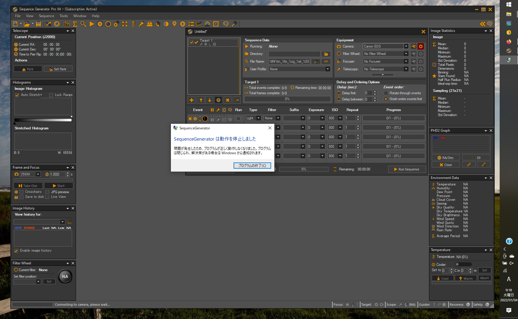

SPG will crash when connecting EOS-1Dsmk3
1.chose EOS camera
2.deside data type to FITS
3.toggle power-on switch in the Equipment chooser
4.them alart will apear can’t go-on to shut down.
That’s all.
PC is HP Elitebook 8570p i7 64 bit win10 21H2
16G memory 598G free area on SSD c drive

Hmm. I cant find anything that shows the camera connecting… For this step that you describe, can you tell me what the alert reads?
It appears in Japanes .
saying,
"Squence Generator had stopped.
This program could not work because of a trouble.It will be shut down.
In case of Windows could find the solution, you’ll be notified. "

So SGPro 3 works fine? I wonder if this is maybe a 32 / 64 bit problem. Would you mind checking if the SGPro 4 32-bit version exhibits the same issue?
O.K.
I’ll try tomorrow.
Hi, I installed Sequence Generator 4.1.0.726 (32-bit)
and tried
It worked fine without trouble, both preview and event progress.
Hm, ok, Thanks for trying. We’ll see if we can get a digic 3 camera to test with 64-bit.
