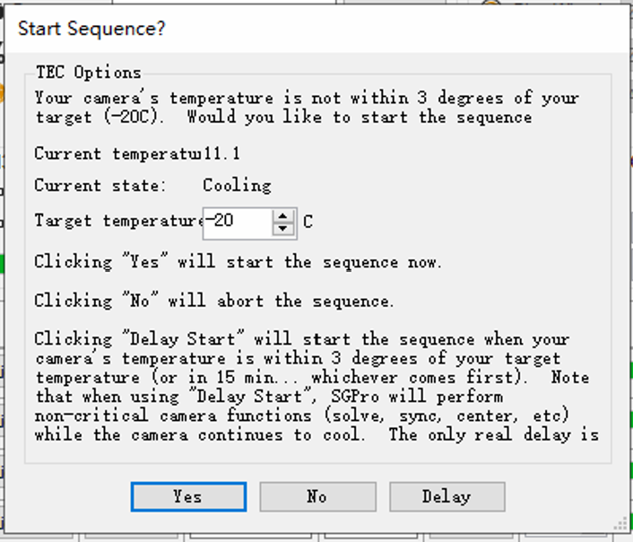

Start Sequence without waiting for camera to reach the target temperature
Can anyone advise, how I can get this box show again, so that I can click Yes, to start the sequence without waiting?

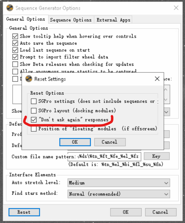

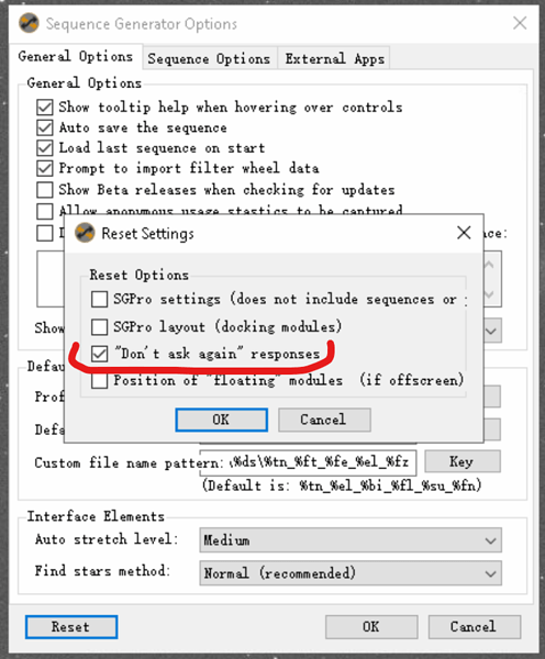

I have reset, the “don’t ask again” response.
Thanks in advance.
I am unsure. I went through the process of resetting it as you have noted above and it worked without issue and started showing the TEC prompt again. What version of SGPro is it?

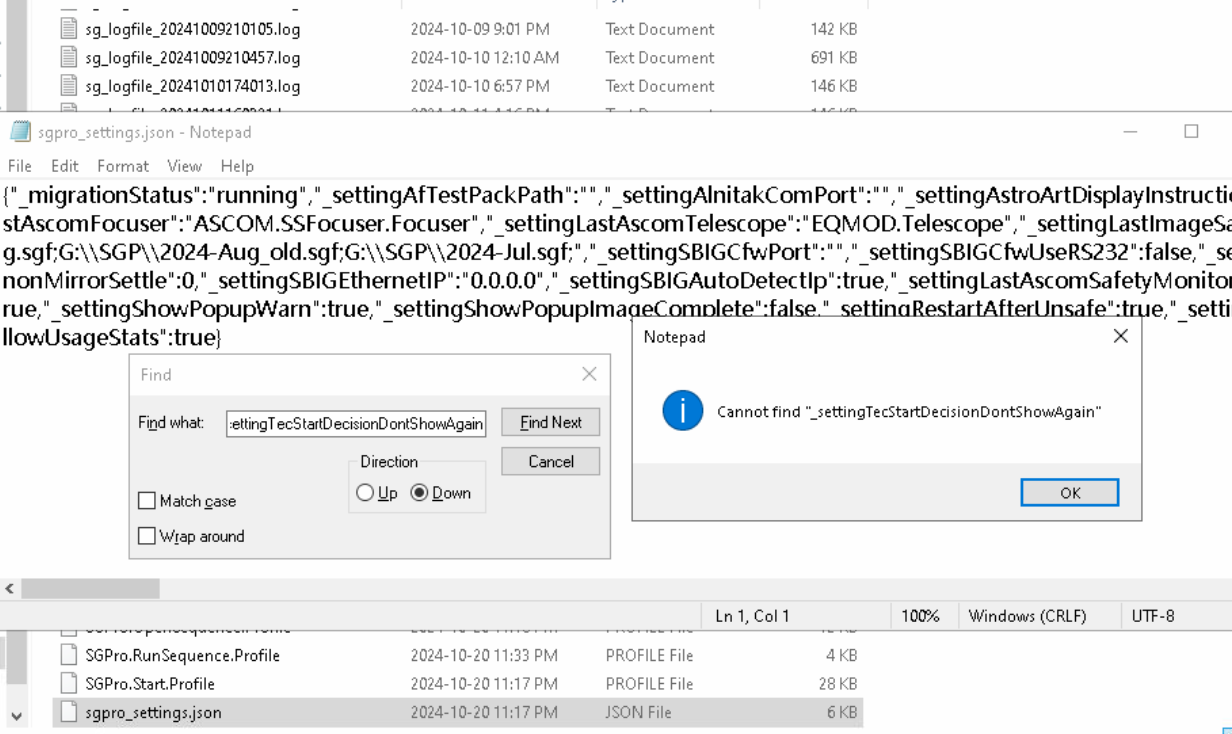

Oh, OK. I can’t recall exactly, but there was likely a bug in the reset for that version. One level above the log folder (Help >> Open Log Folder), you should find a file named sgpro_settings.json. You can open this text file and find _settingTecStartDecisionDontShowAgain. Replace whatever value is there with 3 should clear it.
"_settingTecStartDecisionDontShowAgain": 3,
Thanks for your quick reply.

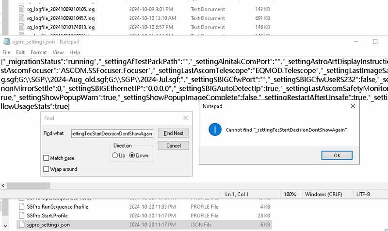

I search the file but do not find the string there:
