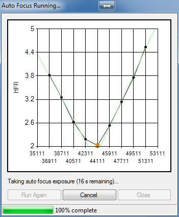

As I watched my auto focus routine run, I would notice that often times the final V curve would not be symmetrical. I did not give it much thought however, since my subs are always well focused. But it started bugging me – why are they not symmetrical? Then it became obvious – the V curve will only be symmetrical when the camera is already in perfect focus when the AF routine starts.
My focuser has very good built-in temperature compensation but its coefficient must be carefully determined. These asymmetrical V curves showed my focuser was not keeping up with the temperature shift between AF runs – close but no cigar.
Here is a typically AF run I was seeing:
So I decided to change my TC coefficient by 25% and see the effect:
These were NB subs, so there was 30 minutes between AF runs. Clearly I had adjusted it too much and in the wrong direction as the asymmetry was worse and in the same direction. So I moved it back to its original value and then moved it 10% in the other direction:
A tad too much but pretty close!
A final small tweak and good enough!
By ensuring good TC on your focuser, you can have confidence that 30 minute narrow band subs will hold their focus throughout.
