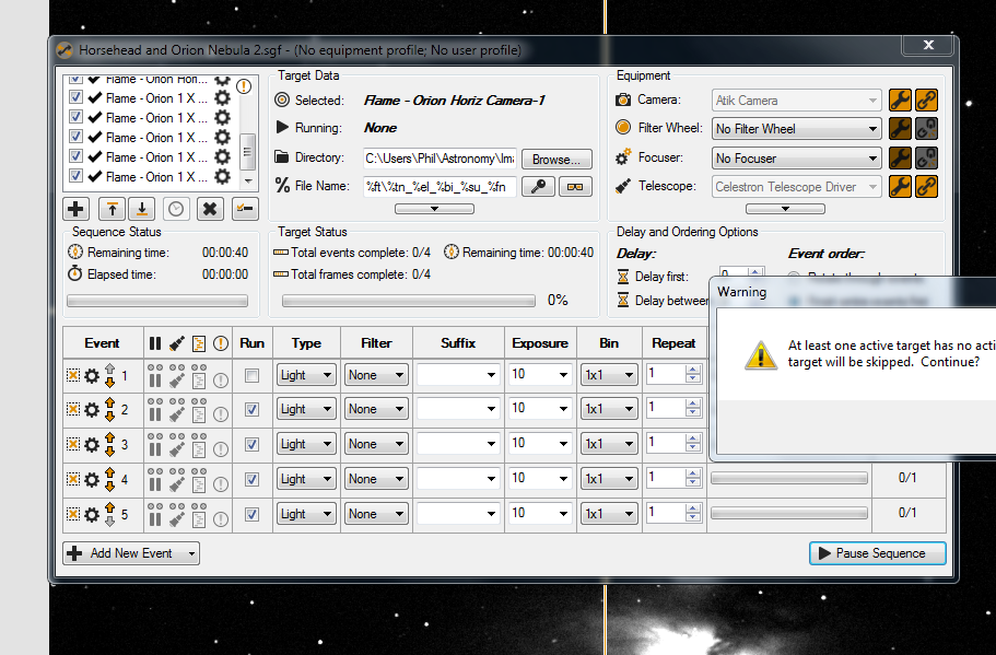

Unable to SGP setup
All I have: Celesrton CGEM DX, Atik 460EX Mono, PHD2 with Lodestar autoguider.
What I have done: Camera and mount comms, Created a mosaic sequence, Slew & platesolve.
What I need: Is to have the system prompt me to rotate my camera and to run a sequence. I followed the help file instructions to convince the system to prompt me to rotate which it does not.
Errors: At lease one target has no activity. I just noticed one of the events doesn’t have a check mark (so what). I tried many times I’m sure one had checkmark. Then after this has a long list errors (one for every target). I just want it to take some pictures.
You have not said what errors you are getting and the screen dumps don’t help in that regard. If you want SGP to prompt you to rotate your camera, you have to add the Manual Rotator to your device list. Can’t tell from the screen dump if you have a rotator defined. A target without the check mark is not going to be run. If you want help, you have to provide enough information for someone to diagnose the situation.
It should not be happening for each target. Just for any target that has no active events but the target is active. If you can attach your sequence I can see what’s going on.
Thanks, I’ll try adding a manual rotator.
