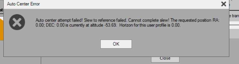

also when i try to center the object in sequencer i get this error message.

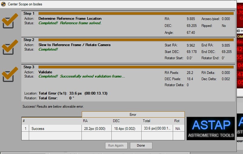

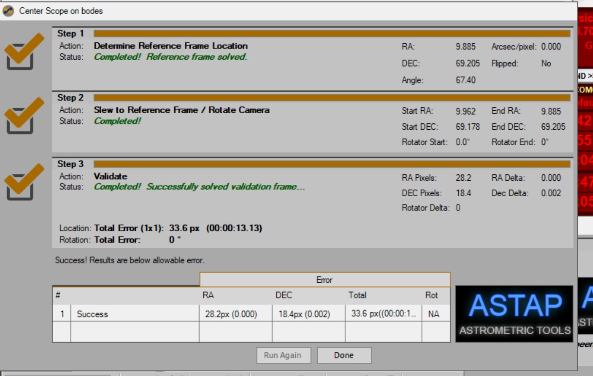

Heres the log from last night it solved with ASTAP but it didnt center the target. also included is a picture of it solving but not centering.

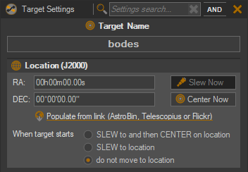

This is because the configured target in your sequence has no location specified:
Happy to take a look, but the attached logs do not contain any centering attempt. You can use SGPro to send the logs… no need to find and package them up manually.
how do you center the object. i thought you just press ‘sync’ in the platesolve tab. also i right clicked ‘center this target’ in the sequencer and it doesnt center. what do you do to center the object is there a setting or something? what about center the object when a subexposure is downloaded. would centering there do it?
The sync button does not center the target, it simply plate solves the current location and syncs your telescope to that solved location.
Typically centering the telescope on a target is not a human-monitored process and is executed as part of a normal sequence. That said, if you need to manually perform target centering, you can provide target coordinates in target settings and, anytime afterward, right click the target and click one of the centering options.
For additional info on Target Settings:
yeah you said there was no centering in the logs. how would i center or how would i center a target?
Please see the documentation I posted above starting Traget Context Menu
