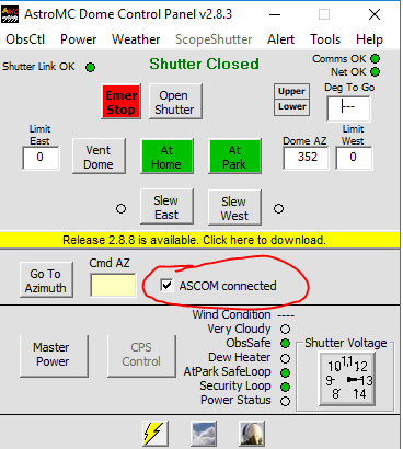

I just installed AstroMC 2.8.4beta which is the only working version that allows the dome to be controlled by SGP. It is communicating but I can’t tell if it is synced and I am confused about if I need to sync it in SGP. A bit of info about how AstroMC should be set up to be controlled by SGP would be helpful.

I would stick with latest 2.6 version for now - it should work. I don’t have a Paramount, so can’t help you on that end. For AstroMC, just need to make sure the “ASCOM connected” box is checked:

For me, I usually open the dome shutter using AstroMC and then make sure “ASCOM connected” is checked in AstroMC. Then make sure “Slave to Telescope” is checked in SGP and “Mount Park closes shutter” (and “Disconnect all equipment at sequence end”) are checked.
I have had success further automating the process (ie. scheduling a sequence start for later time when I am not at console, having SGP open shutter etc.) - just need to make sure “ASCOM connected” is checked in.AstroMC. But this level of automation means more things that can go wrong so I don’t normally attempt it if I am at the console (and by “console”, I mean able to RDP into the obsy PC).
