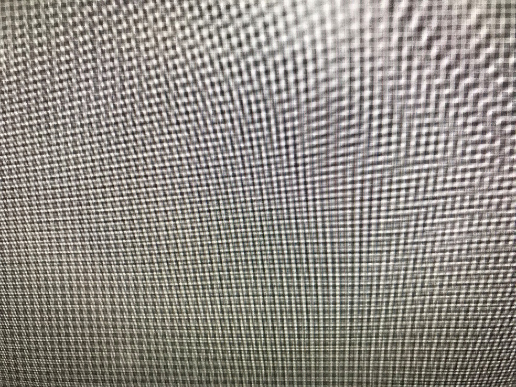

Can someone help me out with this camera in SGpro it’s a zwo asi224mc camera… when I image I get little squares all over my images? Gain 135 offset 20 and all so what should my ADU be for this camera in SGRo thanks again
Isn’t this the raw image prior to the debayering? These squares are in black and white and by debayering it, you will get a colour image.
Thank you for that! I’m still learning… how would I debayer it? And once I do that the squares will go away? Thanks again
As far as I understand it, it is done by the software used to stack and develop the photos. I have found that the debayer pattern for ZWO cameras is GRBG. There are many software options. If you go to the ZWO ASI website they will guide you to the most appropriate software to use. There are many who state that one brand is better than others but the most important thing to do is to get stuck in and climb up the learning curve.
